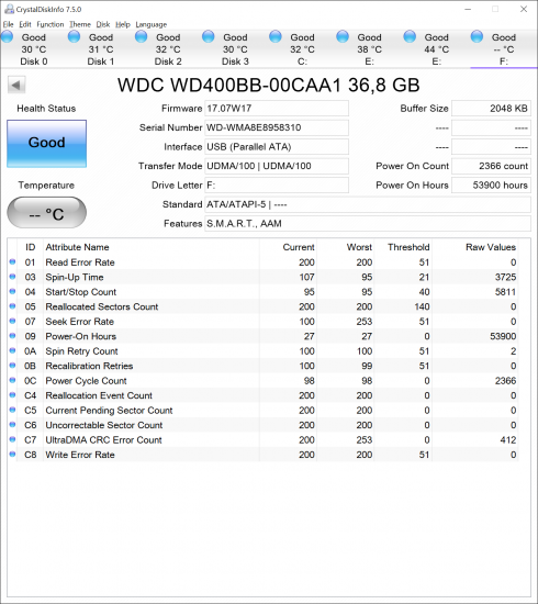

Hello, I'm having trouble with this old drive. I can't use full capacity. The nominal capacity is 40GB but I can use only 36.8GB.
I use this setup:
ASUS P4P800-VM with Pentium 4 2.4GHz
Drive is connected to Primary IDE with 80 core cable on master position with no jumpers. In BIOS in IDE Configuration I tried to select both Compatible Mode and Enhanced Mode.
The drive works otherwise normally. I can format it, move files and so on.

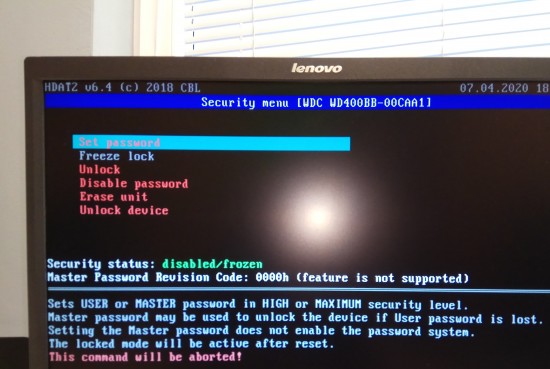

hdat2:
In security menu are all options red - this command will be aborted.
In Hidden areas menu no option available which would allow me to change anything.
It allowed to dump a module 42. (In attachments above SMART data photo)

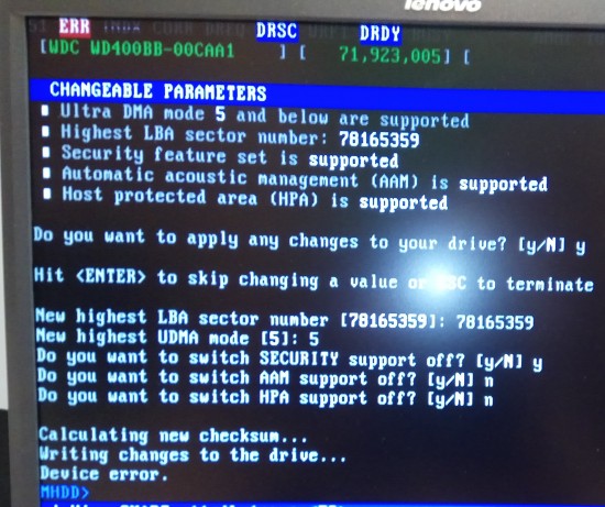

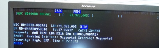

MHDD:
NHPA - ends with fail.
CONFIG - ends with fail.
ZU (to delete ATA password):
command zu /P
says NO PWD.BYE! --> this message it showed only when the IDE Configuration was set to Compatible Mode. In Enhanced it was only measuring time.
