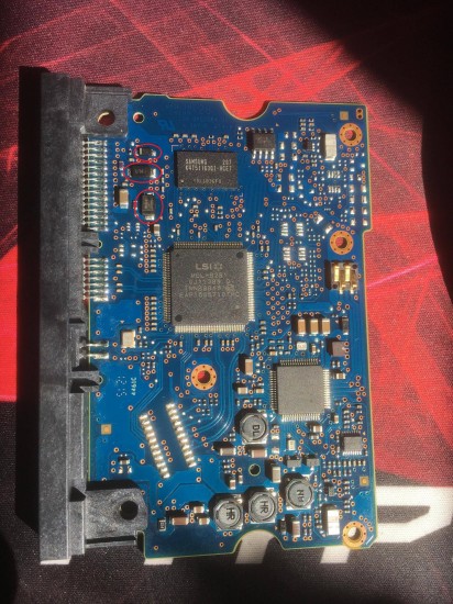

hi all,
so i plugged in wrong SATA cables and shorted out the PCB on my Hitachi Ultrastar 2 TB.
rather than replacing the PCB. I would like to fix this by removing (or jumping?) the TVS diode.
can anyone help me find the location of it? And should I jump it using a piece of wire or remove it completely?
completely newbie, no heat gun, no soldering iron on hand. But can get one.
https://i.imgur.com/LUImBKS.jpg

Forgot to show a picture of the PCB, here it is:
https://imgur.com/a/6D8bxLJ

check the attached picture better replace them if Data is important visit any Data Recovery Professional near you it wont cost much for electric problem,

I actually ended up snipping (cutting off) all three of those diodes. But still no power.
I notice that the board gets hot on one of the right hand corner of the area (those circle thingies on the right).
Just ordered a PCB, Data is important so I am hoping a new PCB will do the job. I guess I'll have to transport the ROM chip from the old PCB to the donor.

Which diode was shorted? I suspect it was the 5V TVS diode (SUA GP205), in which case there is a slight risk that the preamp may have been damaged.
A "ROM/NVRAM transplant" shouldn't cost more than US$50. Contact hdd-parts.com (they are located in Canada).
However, a transplant shouldn't be necessary if one of the two fuses is open. If there is no other damage, just flow a blob of solder over the relevant fuse. That should cost you nothing. The fuses are the small components to the left of each of the two diodes. ("14" is the 12V TVS diode)

while I wait for the donor board to arrive (was ordered from Israel through Ebay). I want to try your suggestion. The thing is I'm a noob, so without pictures, I cannot piece together which component you are talking about to solder over (where is this fuse?)

littlemoule wrote:I notice that the board gets hot on one of the right hand corner of the area (those circle thingies on the right).
You haven't measured anything, so it's not possible to help you. However, if you are referring to the HR and DL coils, then that could point to a problem with the Vcore supply voltage for the MCU chip. If so, then a PCB swap would be preferable.
