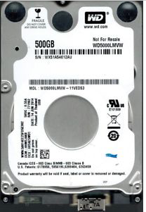

I need your help. I've recovered a 2.5 hard drive. The hard drive boots and then shuts down.
It's not detected by my windows or any other system.
With nothing to lose, I opened the door and I saw the problem.
The disc starts and stops and so on and so forth. The drive head doesn't move either.
The disc has its connector soldered directly.
Do you have an idea of the problem
thank you for your help

By “hard drive boots and then shuts down“ I assume you mean it spins up, clicks a few times, then spins down?
If so, then it’s a physical issue (bad/damaged heads) which is usually caused by a drop or other physical trauma. Not necessarily immediately prior to the failure.

Thank you for your answer.
It doesn't click and the playhead is not on the disc. It's in its slot.
The tray goes on and off and so on. That's all.
The head does not move.

As I told you, the problem may be at least a couple, but you don't want to know what the problem was, since you performed processes that nothing indicated were necessary and complicating the resolution of a case that, yes, was very likely to be very simple (failure in the connection between PCB and head block), now the patient already has bigger problems....

angoul wrote:With nothing to lose, I opened the door and I saw the problem.
Most likely he's powering the drive on without the lid so the HDA is no making contact with the PCB that's why the heads aren't moving. Take it to a DR specialist if you care about the data, no much you can do No DIY
