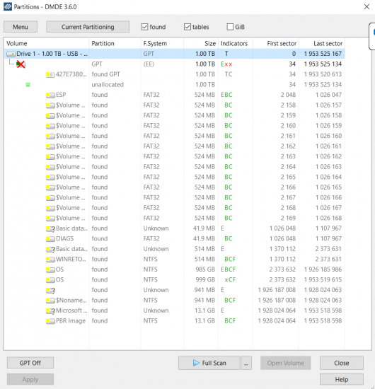

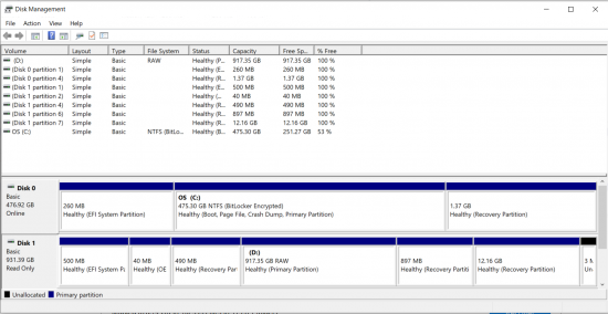

Can you show us the Partitions window in DMDE? I'm wondering whether your USB-SATA bridge is configured with a sector size of 4KB, and whether your data recovery software is confused by this. A DMDE screenshot would clarify this.

My recovery software (Stellar) does not have a window for partitions as far as I can see, just the drive itself. Once in the drive, the tree view shows folders inside but once again, no partitions. I have taken a screenshot of the partitions in Disk Management if this is of any help to you? If not, if there's any other way you know I could check for this issue that would be really appreciated!

No, what fzabkar is saying is that you should download DMDE software and show us the partitions table from DMDE.

Oh, I'm sorry I was unfamiliar with the software. I do apologise. I have downloaded the software and taken a screenshot for you here.

Have you looked in the 2 OS folders? That's where the user data should be.
Re: Data recovered from HDD doesn't have contents
August 21st, 2020, 15:30
The data should be in the first of the OS volumes (EBCF indicators). Double-click this volume and expand the $Root.
August 22nd, 2020, 4:59
So... interesting but amazing turn of events. The DMDE software is able to recover the files that Stellar and EaseUS can't! Using the same files from the same OS directories. I'm in the process of recovering now. Thanks guys, I appreciate the help!
