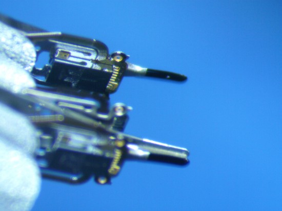

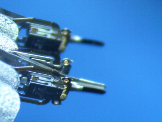

October 2nd, 2020, 20:08
I don't know what kind of mistake it is, I'm trying to reach a mutual non-aggression agreement with these units.... I don't know if the error is directly related to this, but I bet that SA is degraded or simply doesn't exist anymore (at least a part of it).
