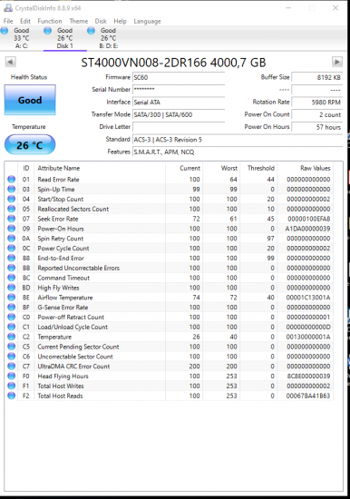

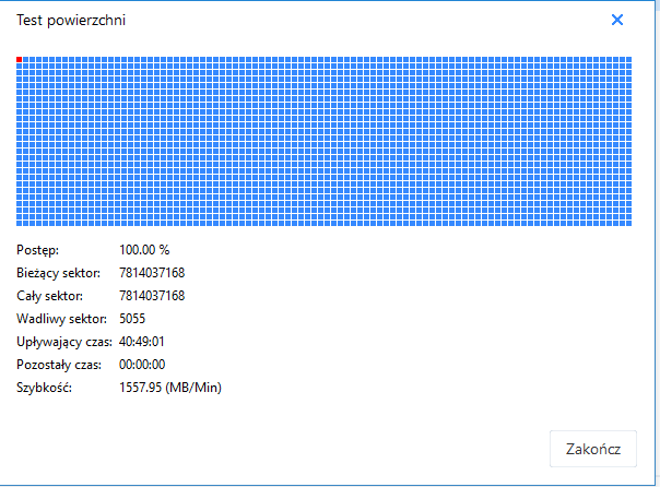

I recently bough a new IronWolf for my NAS and wanted to test it in my PC at first.
Could anyone review attached results and tell me if I should be worried?

December 16th, 2020, 14:10
Progress 100.00%
Current sector: 7814037168
All sector: 7814037168
Bad sector: 5055
Current time:40:49:01
Remaining time: 00:00:00
Speed: 1557.95 MB/Min
Re: New IronWolf 4TB - is it corrupted?
December 16th, 2020, 15:53
Your results do not show any problems.
December 20th, 2020, 7:07
And what about bad sectors pointed by EaseUs program in the number of 5055?
December 21st, 2020, 14:32
Does your SMART report show the state of the drive after the surface scan, or before?
Your transfer rate is 26 MB/s. That's a USB 2.0 speed. Was your drive connected externally?
