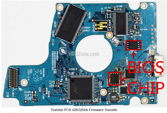

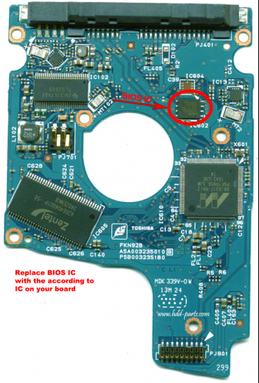

I have a Toshiba USB drive, PCB number G003250A
Looking for compatibilities, I found out that the PCB G003235C is compatible.
The problem is how do I know where is the BIOS chip I need to swap.
I have attached 2 pictures for ilustration purposes.
Your help is greatly appreciated.
This is the compatible SATA PCB
This is the USB failing PCB

IC602 is the one, as it is the only one on the SATA PCB.
