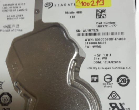

I need ROM ST1000LM035 1RK172-177 FW:HWM2
May 6th, 2021, 21:15
Error this.
Bad CRC Seg:0x06
LED:0x000000BB FAddr:0x00004A18
Or anyone can fix drives ROM file ?

The main problem is that a large part of RAP is erased, hence the CRC error. A bit less serious problem is that CAP is also erased.
I don't say it is beyond recovery but 1.) it needs a significant amount of research, 2.) most probably it won't be recoverable after that, 3.) it would cost a lot even if no results at the end.

I have give this drive to another DR. Then can't solve. Also MRT tecnician analysing ROM.
Problem occured sudden electrical shot down custumer said.
