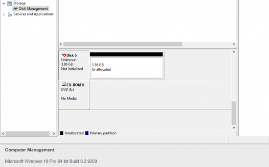

Running Windows 10 pro, went to access my HDD and it was not there, it worked perfectly yesterday, so I checked the computer management and it was recognised as Disk 6, not initialised, and unallocated. Attempting to initialise brought up a data error (cyclic redundancy check). So it appears to be toast. I can hear it winding up when I turn it on, but that is it. This drive has a load of data on it, and I would really be in a fix if I lose it. The drive is a 2TB Seagate Expansion Desktop drive.
Any ideas would be very much appreciated.

One thing I forgot to add, the Drive is a 2TB, but is showing up as 3.9TB in computer management. This is very strange.

That looks like 3.86GB not 3.86TB.
Which could be the default values if the drive can not read the SA. What does the computers bios say about the drive? I assume you have it connected directly to the motherboard for testing - if not start there.

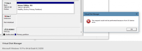

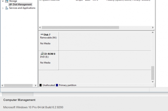

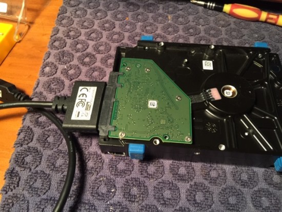

Not sure what you mean by connected to the motherboard, it is not via a hub, but straight into the computer USB 3 port. Today I thought what the hell so I removed the drive from the case and unplugged the interface card and re inserted a sata adapter, plugged back into the computer and still not recognised, but computer management found the drive as disk 7 removable M drive with no media on it..as per capture.

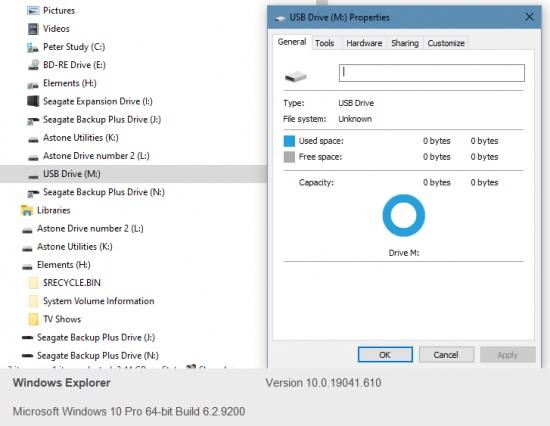

Just another shot showing in Windows explorer it is now recognised as M drive but nothing can be done with it as windows cannot access the drive. If I remove the sata cable and reconnect the original interface I get a totally different result from within Computer management and it does not show up at all in Windows Explorer. It takes forever to come up in Management.

You need to connect the drive to motherboard not via USB, USB can interfere with things. Once connected to the motherboard via sata check your computer bios - does it see the drive and does it report the correct size.

That 3.86gb is the default “fake” capacity shown by a failed Seagate F3 drive, just picked up from the PCB.
The drive cannot read from the SA (Service Area) where the firmware is situated, so there’s most likely some physical issues.
There’s absolutely nothing you can do DIY on this, requires a pro. Sorry,
