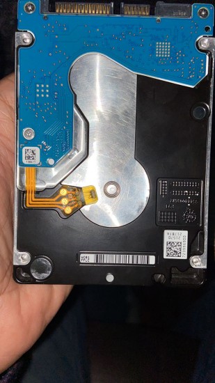

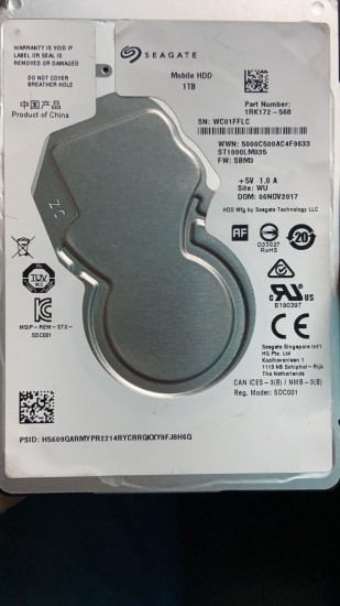

Sorry for my bad english. I have one hard disk ST1000LM035 1RK172-568 and firmware version is SBM3. suddenly it was stop while transffering data. it has no power issue. it came in Transcend USB 3.0 casing. I do following steps for checking.
1. i remove pcb and check voltage and its ok.
2. i change pcb from another hdd, patient hdd spinup but not detected and normal clicking noise from it.
3. i connect it with terminal programme and it showing this error in terminal command.
Flash boot code Digital Signature Verification failure!
0x0020
0x0020
0x0020

4. I disolder the firmware ic and read it with RTF809. I attach rom file.
5. I disolder the firmware ic from another hdd and read it with RTF809. I compare both rom file and in rom file i noticed that patient half of the file is blank.
Can anybody help me to remake rom file so i copy my important data from patient hdd?
I attach hdd pic and also rom file.
Thanks in advance.

If I understand your post. The drive does not power on with the original PCB but does power on with a donor PCB ?
If that's the case it's a lot easier to fix the original PCB than do anything else. Start by posting a hi res picture of the PCB.
It also looks like someone's peeled the label - has someone opened the drive?
If the data is important to you I would suggest you find a DR professional these drives are not easy to work with https://www.cheadledatarecovery.co.uk/2018/02/st2000lm007-st1000lm035-worst-hdd-ever/
