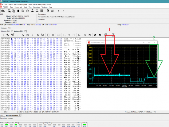

I wondered if anyone has seen the following error reported in PC3000 before:
"DISK SERVO WRT FLT PREDICTIVE OFFTRACK ERROR"
It comes about when trying to write an entire firmware module to the SA. Writing data starts normally, but then for larger modules produces this error. When making a check on the heads, when writing small amounts of data (a few bytes) to an existing module the (donor) heads read/write fine. It appears that the write failure occurs when there is a large sequential write of 100KB+.
I'm working on an FBLite. Originally opened up by a PC Shop so changes to the inside of the HDD may have been made. Heads had failed. I've tried multiple donor heads - the results are replicated. When using donor heads it is possible to calibrate the HDD to RDY by blocking access to the SA in ROM either by shifting regions or blocking mod 30. Then once RDY it is possible to access SA in the normal manner and read all critical modules. However, because the HDD cannot write fully the HDD will not calibrate when SA access is allowed.
Any suggestions?

October 5th, 2021, 8:27
The original patient ROM and rebuilt ROM from SA match OK. The differences I saw were in a version that I had spared regions. As such, I am running short on options for this HDD.
- Donor head incompatibility is very unlikely given the circumstances.
- The sequential writing fault in the patient HDD resulting in the error "DISK SERVO WRT FLT PREDICTIVE OFFTRACK ERROR" is replicated in the donor HDD when patient SA and patient ROM is written to the donor.
- Disabling write cache, read-look ahead and other features does not make a difference.
Below is a screenshot showing the current usage when the HDD is powered on. Annotated with the number 1) is when there is no block to the SA in the ROM. The current drawn is higher, and the HDD makes a slight buzzing sound, I presume as the HDD is trying to make some write attempts. Annotated with the number 2) is when module 30 is blocked in the ROM. The HDD enters RDY and Kernel mode normally. This fault is replicated (including the buzzing sound) in the donor HDD when patient SA and patient ROM are written to the donor HDD. It is not replicated in the donor HDD when only using the Patient SA and donor ROM.
If anyone has thoughts on the matter then I would love to hear them!
Best regards,
John

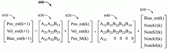

It may be a red herring, but I found this WD patent dated July 7, 2009:
DISK DRIVE SERVO CONTROL TECHNIQUES FOR PREDICTING AN OFF-TRACK CONDITION UTILIZING AN ESTIMATION FILTER:
https://patentimages.storage.googleapis.com/82/a9/6f/34aa2838129a3b/US7558016.pdfBasically it uses a filter algorithm to predict whether the next write will be offtrack, in which case it pre-emptively shuts off the write gate. It uses a matrix whose coefficients are determined at time of manufacture. I expect that these "adaptives" would be stored either in the ROM or the SA.
The servo controller implements an estimation filter and performs operations that include: determining a current position estimate of the moveable head relative to the track; predicting a subsequent position estimate of the moveable head relative to the track based upon the current position estimate; and determining whether the predicted subsequent position exceeds an error threshold.
it should be appreciated by those of skill in this art that state modeling coefficients (e.g., A11 A12 etc.) for state matrix 630 and control modeling coefficients (e.g., A13, B11, etc.) for control matrix 640 in terms of position, velocity, and bias may be determined by well-known characterization techniques during the disk drive manufacturing and testing process for use in the above-described Kalman filter 600 during operation of the disk drive.
