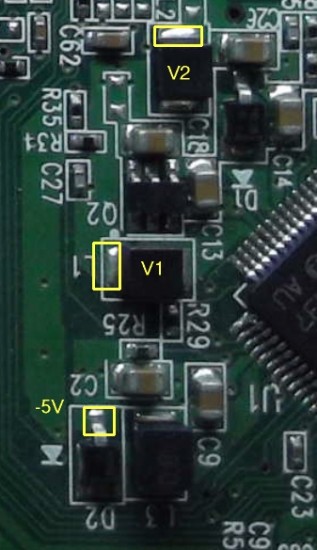

Have 500GB WD With 2060-701590-000 Rev. A
HDD no spin and bsy
Had Read ROM using WDMarvel. I don't have Donor PCB.
I tried with 2060-771590 hdd spin So no Motor issue
here attached PCB Picture from Net (My camera Image is not good, PCB has no Burned Sign)
Someone guide check Points to repair PCB

Continuity at R67, R64 , D3, D4.
Voltages at L1,L2,L3
Re: 2060-701590-000 Rev. A - No Spinup
October 22nd, 2021, 3:44
Continuity at R67, R64 , D3, D4. - OK
Voltages at 1.16v L1 1.22v , 2.53v L2 2.55v , 0.0v L3 0.0v

gps31 wrote:Continuity at R67, R64 , D3, D4. - OK
Same from a known working 2060-701590. Any errors on the modules?
October 22nd, 2021, 9:45
Got PCB from Local market for Rs. 200 (have to search Many Places)
After Rom Transfer HDD works fine.
Thx for your support

These are the voltage test points.
