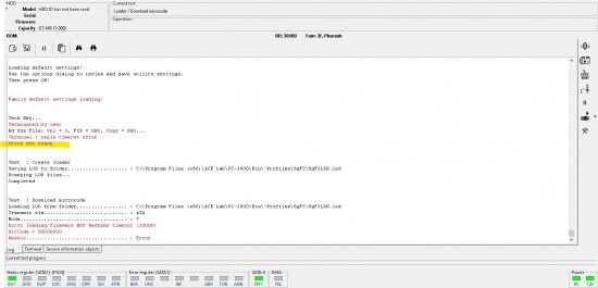

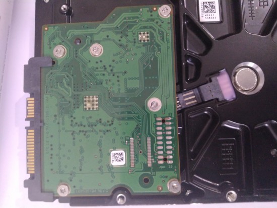

I have following hard disk. It stays busy but is not making clicking noise nor getting spin down.
Its not coming to terminal as well. I have tried to change PCB (by swaping rom) but symptoms does not change.
Does this disk belongs to Grenada which needs to unlock (patch) first.
Family -- Seagate Barracuda 500 GB
Model :- ST500DM002
Firmware :- KC45
PCB Rev. :- 100535704 Rev . C
Can someone pls. give shorting points

This drive belongs to Pharaoh family.
Check terminal output, what does the log report when powering on?
Re: Seagate Barracuda recovery
April 14th, 2022, 9:22
michael chiklis wrote:This drive belongs to Pharaoh family.
Yes Michael Sorry
This is pharaoh family . Terminal shows following --

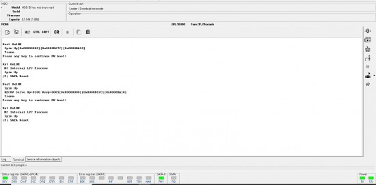

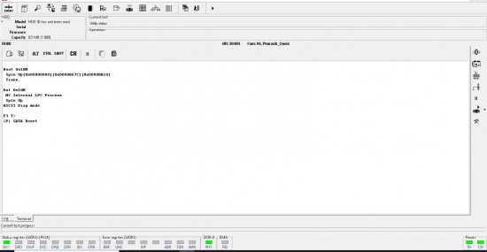

April 15th, 2022, 0:09
michael chiklis wrote:You can try to load Virtual LDR, you can get it from sys 20D of a good donor drive.
I Think first step needed for this drive is to gain access to terminal first. I can't read sys files ,loader is also of nouse.
Terminal is giving new message now. I think head transplant is needed.

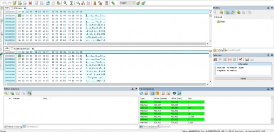

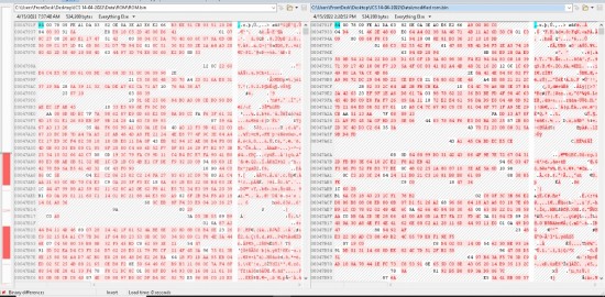

update to case ---- all efforts failed so far and drive is not giving sector access. I think pathching rom could be the issue.
There is difference between original rom and patched rom. I am attaching both copies --
download :-https://drive.google.com/file/d/1XdMojoPF-q68VNQfqSy84H41zLwClWmC/view?usp=sharing
finally I am transplanting heads as only that is left.
