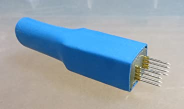

Dear HDDGuru Community,
I have some newer WD USB/SATA HDD to recovery and I intend to use the new SED unlocking feature in PC3k. I wanted to use the programmer with a clip (CH341A). The only problem is that the clip is working only with thicker ROM chips (from older WD drives), the new chips from Charger/Palmer/etc. are too slim to read. How do you guys read the ROM chips without unsoldering?
Thank you very much for any help!
Oliver
Re: Reading ROM from newer WD drives
October 27th, 2022, 13:09
With this
November 1st, 2022, 8:59
Alternatively try one of the higher end probes here:
https://sigrok.org/wiki/Probe_comparison
Or if there is no way to attach a probe to the chip at all. The commercial or DIY version of this:
https://blog.acelab.eu.com/pc-3000-flas ... se-it.html

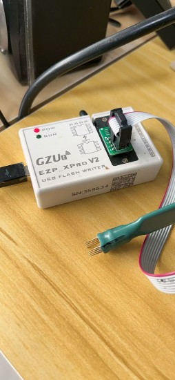

November 1st, 2022, 23:26
Hi Oliver,
I have Programer and Adapter Clip Pin Flash on-Chip Read and Write Probe.
Please contact me,Jieshan Weng
