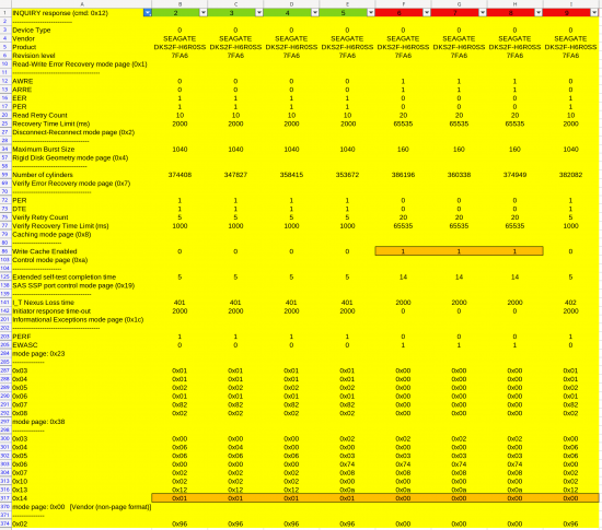

[0:0:0:0]    disk    SEAGATE  DKS2F-H6R0SS     7FA6  /dev/sdc   /dev/sg2
[0:0:1:0]    disk    SEAGATE  DKS2F-H6R0SS     7FA6  /dev/sdd   /dev/sg3
[0:0:2:0]    disk    SEAGATE  DKS2F-H6R0SS     7FA6  /dev/sdg   /dev/sg6
[0:0:3:0]    disk    SEAGATE  DKS2F-H6R0SS     7FA6  /dev/sdh   /dev/sg7
[5:0:0:0]    disk    ATA      Samsung SSD 870  3B6Q  /dev/sda   /dev/sg0
[6:0:0:0]    disk    ATA      Samsung SSD 870  3B6Q  /dev/sdb   /dev/sg1
[15:0:0:0]   disk    SEAGATE  DKS2F-H6R0SS     7FA6  /dev/sde   /dev/sg4
[15:0:1:0]   disk    SEAGATE  DKS2F-H6R0SS     7FA6  /dev/sdf   /dev/sg5
[15:0:2:0]   disk    SEAGATE  DKS2F-H6R0SS     7FA6  /dev/sdi   /dev/sg8
[15:0:3:0]   disk    SEAGATE  DKS2F-H6R0SS     7FA6  /dev/sdj   /dev/sg9
See attached. First 4 drives highlighted green (sg2-sg5) are the ones that work (allowed writing GPT and data), last 4 highlighted red (sg6-sg9) are the ones that throw write error. Out of 4 non-working ones 3 have Write Cache Enabled (I can disable it with smartctl but it is a volatile change: as soon as drive is pulled out, it goes back to enabled). So I believe most of the diffs are related to this option enabled. Each working - non-working pair uses separate sff cable between the backplane and HBA and I have 2 HBAs to eliminate any connectivity questions.
HOWEVER, there is one difference that matches the working - non-working pattern: Mode Page 0x38, line 0x14. I need to see if I can change it and if it helps.
BTW the thing that I find unusual is every drive has a different number of cylinders. Not sure if this is normal.

Well, sg_modes -p 0x38 -c 1 /dev/sg9 says it is changeable:
    SEAGATE   DKS2F-H6R0SS      7FA6   peripheral_type: disk [0x0]
Mode parameter header from MODE SENSE(10):
  Mode data length=88, medium type=0x00, WP=0, DpoFua=1, longlba=0
  Block descriptor length=8
> Direct access device block descriptors:
   Density code=0x0
00     ff ff ff ff 00 00 02 00
>> page_code: 0x38, page_control: changeable
00     b8 46 ff ff ff ff ff ff  ff ff ff ff ff ff ff ff
10     ff 00 00 1b 01 00 00 00  ff ff ff ff ff ff ff ff
20     00 01 00 00 00 00 00 00  00 00 00 00 00 00 00 00
30     00 00 00 00 00 00 00 00  00 00 00 00 00 00 00 00
40     00 00 00 00 00 00 00 00
Let me check if sg_wr_mode allows me to change this.

So far so good: sg_wr_mode went through on sg9 (the one drive w/o write cache enabled) and I was able to create a partition table. I have to check if this change is permanent and attempt to fill the drive with data.
Re: ST6000NM0034 DKS2F-H6R0SS 7FA6
December 6th, 2023, 17:59
The good: sg_wr_mode went through as mentioned above.
The bad: the change is volatile, as soon as the drive is out, it is reversed and drive goes back to the original mode. I tried mkfs.ext4 on the partition I created earlier and it threw write errors. After rerunning sg_wr_mode I was able to successfully complete mkfs.ext4 and I am currently copying data to the drive.
Next step: find a way to make the change permanent. Any ideas?

It works. The final thing would be to make sure I can disable Write Cache permanently. The smartctl command still works on volatile basis. I can probably use sg_wr_mode to force the change made by smartctl, but after seeing all the diffs between the drives WITH and WITHOUT Write Cache enabled I wonder if there is any performance difference.

Oh I am disabling Write Cache no question asked. But when I looked at the diffs AFTER I used smartctl command the only difference was 0 in the Write Cache Enabled field. And if you look closely there are a bunch of other differences between drives with WC enabled and disabled and I debate if I should change these fields to match the values in the drives with WC disabled.

I disabled the Write Cache and decided to align the mode pages 0x0, 0x1, 0x2, 0x7, 0x8 (obviously), 0xa, 0x19, 0x1c, 0x23 to the values from sg2. So far it works.
There are too many differences in mode page 0x38 to make any changes without understanding each byte. If Seagate shares any info on this mode page (which I personally doubt), I can get back to this topic.
