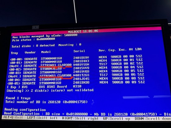

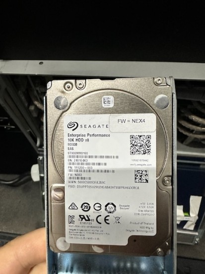

I have server with Seagate Enterprise Performance 10K HDD V8 (SAS) disks. Disks have OEM firmware. Now 2 disks failed. I contacted with server producer and it looks like they don't support this server anymore (it is "too old"). On local market I bought 2 new Seagate Enterprise Performance 10K V8 disks but ... I can't add them to my raid. Is there any solution to clone my original SAS drive to new one?
Thank you in advance
Sebastian

What raid level and what error messages appear when trying to add the HDDs?

I have Raid 5. Below print screen from may system.
Thank you :)
