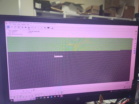

I have this Seagate ST3500410SV 500Gb Drive. Gets ready when turning on with full ID and could even read some sectors before getting in DWF State

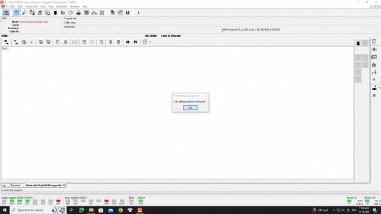

I am trying to use this article from Acelabs to resolve the issue: https://blog.acelab.eu.com/pc-3000-for-hdd-how-to-solve-the-device-fault-state-dwf-issue.html
However upon Reading Sys File Volume 0x00 File ID 0x020D
I got error that No editing Objects are found
How can i resolve this issue???

Edit SMP flags.
