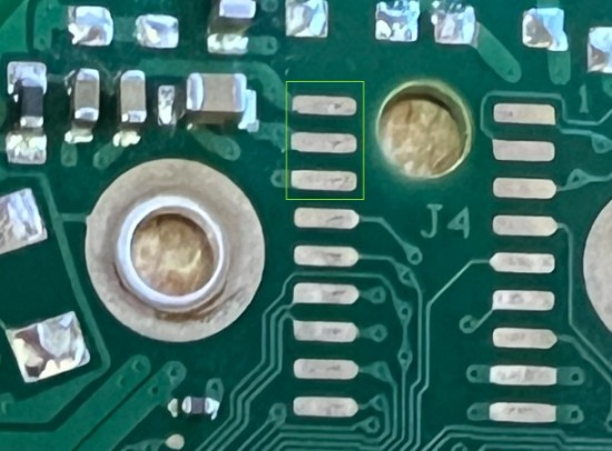

Before you waste money and time on a replacement PCB, you need to confirm that the preamp IC on the headstack (inside the drive) isn't shorted.
The 3 pins in the attachment should be connected to Vneg, +5Vin, Ground. Use your DMM to identify which is which, and then test for shorts to ground at the corresponding pins on the HDA connector.

I just measured the resistance of all 3 with my DMM using one of the metal screw holes on the drive. The first 2 appeared to have some kind of capacitance; the meter reading was in the megaohms and climbed higher and higher. the 3rd pin showed about 0.3 ohms. So from what you said, that sounds about right?

Just be absolutely certain, measure the resistance between the 3rd pin and each of the others.
This is what I'm concerned about:
https://www.hddoracle.com/viewtopic.php?p=22173#p22173

No shorts found; the readings were all quite high. Fingers crossed I may have dodged a bullet with the pre-amp.
