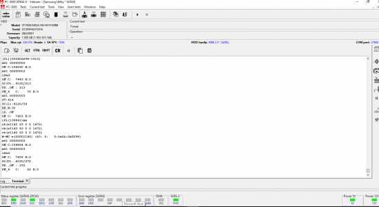

Hi everyone. I am having trouble data extracting with PC3000 of Samsung ST1000LM024 HN-M101MBB
The drive came to me knocking- I already change 1 set of heads. H1,H2,H3 all mapped good except for H0
- Drives was mapping smoothly until it reaches a bad sector. The drive keeps hanging and BSY upon trying to save bad sector into G-List
- If i put DE to map it will hang. However pressing and holding next to read sector by sector the drive runs smoothly
Can anyone guide me to disable G-List so the drives stops hanging???
Many Thanks!

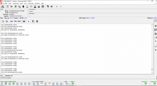

@gameboybin, can you upload a resource dump?
Re: Samsung ST1000LM024 HN-M101MBB How to disabel G-list
March 8th, 2025, 14:54
If you can upload the full terminal log, that might tell us which SA modules are loaded during start-up. One of those might have the relevant configuration parameter(s).
