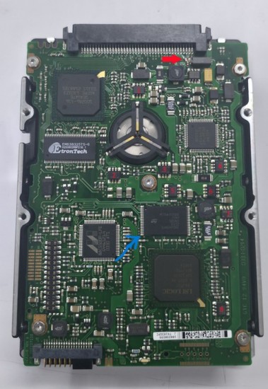

Received 3 hp BD03685A24 SCSI, 2 of them with damaged PCB 100227228, looks like from overcurrent. I have a donor PCB, but don't know where the ROM is.
https://freeimage.host/i/K8KDDzP
https://freeimage.host/i/K8KDbX1

TSOP48, SST39VF400A:
https://ww1.microchip.com/downloads/aemDocuments/documents/MPD/ProductDocuments/DataSheets/SST39LFX00A-SST39VFX00A-2-Mbit-4-Mbit-8-Mbit-x16-Multi-Purpose-Flash-DS20005001.pdf
Did you check the fuse and TVS diode?
Better photo:
https://datarecoverydonors.com/cdn/shop/products/5935.jpg?v=1619633546

fzabkar wrote:Did you check the fuse and TVS diode?
Yes, I did cheched removed the burned TVS, and still no power at all

I managed to image all drives, a simple hotswap of pcb did the job.
thank you all
