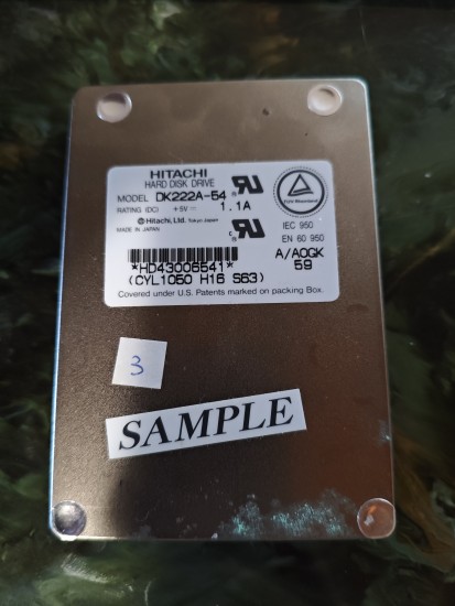

The original HDD – the drive containing the data I am trying to recover.

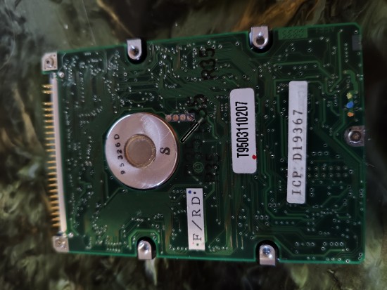

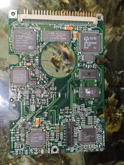

Original PCB – front side.
Original PCB – back side.

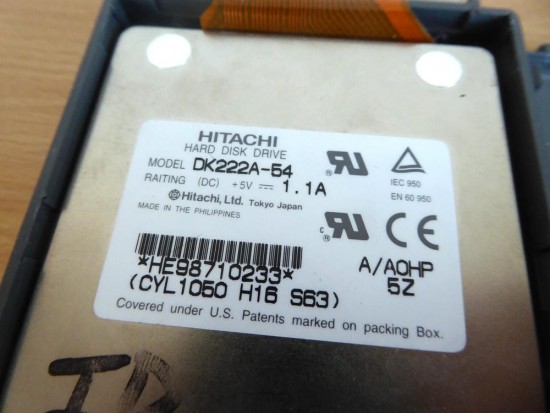

The donor HDD – the drive I found as a possible donor for replacement components.
I made a list of the components I could identify on the PCB:
- Zilog Z86C9524ASC Z8 DSP 9439 KJ
- SRM2A256LLRM70 JAPAN V4Z3487
- ATMEL AT29C256 12TC 9502
- 32P4742-CGT ZS9502 55524F1
- 24.000 KDS 4L JAPAN
- HM62864LT7 9507 000 JAPAN 0G330
- CIRRUS LOGIC CL-SH4600-44VC-D 38642-310BF 9504 F KOREA-B
- GPS CLA71023CG 9502FPL
- Philips TDA5341G J11781 JvJ9448 2
- 4C TY2352
- 51 TY2342
- 9952 EY W448
- 51 TY2342
I’m not sure which of these components, if any, are relevant to diagnosing the failure, so I would appreciate any insight from someone familiar with HDD electronics from this era.

Judging by the ddrescue log, you have almost the entire disk image, missing only the last 160 megabytes. I would first try opening the image with a data recovery tool that supports disk images - such as R-Studio or DMDE - to check if the data you need is already there; further copying of the hard drive might not be necessary. Because further copying could lead to major problems. Judging by the ddrescue log, there is a chance the heads reached a damaged area and failed completely.
I have not opened it yet. The data on it is important, so I would like to avoid doing anything that could make the situation worse.
The first thing you must not do - if the data is truly important - is attempt to open the drive at home or replace the heads yourself without prior experience. The first few attempts at a head swap, even in a laboratory setting and under professional guidance, almost always end in failure.
