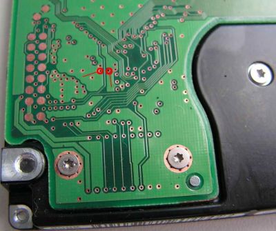

Re: HITACHI HTS424 series password removal
November 12th, 2007, 13:32
Here's a picture I got from Acelab for HTS424.
But it didn't work in my case, so I went with NVRAM method.
hts424 probe
November 12th, 2007, 14:29
Hi Starling,
Nice pic you got from ace.
You know where they got it from ?
You know now why ace so reluctant to publish help and
provide assistance, cause you take some valuable information
you got from ace and you publish it here.
Now you know ace won't get much help (cause they did not discover
IBM solution) so you shoot three shots into each of your own feet
for the future - your own future and many others.
I think you just little boy trying to find beanies for your ego....
November 13th, 2007, 1:03
Starling wrote:Here's a picture I got from Acelab for HTS424.
Hi Starling,
Thank you for the PCB image.
As you have mentioned NV-RAM method works great.
I could unlock the drive easily following the instructions which
I received from you and PCimage :)
Pninja
