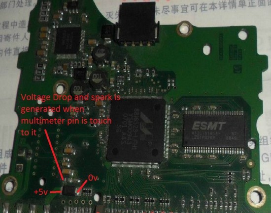

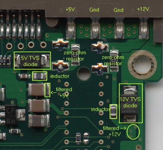

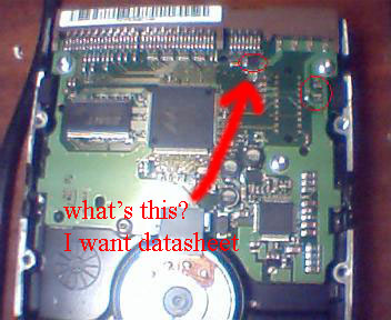

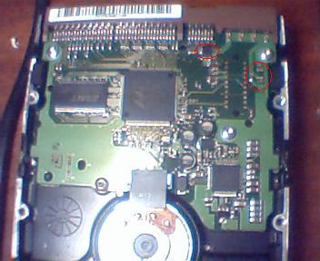

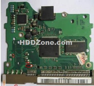

Switch to full style
SANSUNG SP0842N STOP
June 9th, 2008, 21:48
HD sansung SP0842N not completely stopped league apparently was an electric discharge more circuits without apparently burned thank the help now.
Re: SANSUNG SP0842N STOP
June 9th, 2008, 22:14
wich ic´s are damaged ?,some times an electric discharge could be damaged the MHA too, and would be need an MHA exchange on clean room, but u need to check that before, after the hdd begin´s to spin, and check on terminal the log wich its showing, but to do this u need to has experience and knowledgment about the engineering of this brands or send to a DR company
Best regards
Alberto
Re: SANSUNG SP0842N STOP
June 9th, 2008, 22:42
OK, thanks, I will give a considered
Re: SANSUNG SP0842N STOP
June 10th, 2008, 5:10
I think i have one idea.
If you can soldering, try to desolder the capacitor next to the power connector on the PCB.
Sometimes have short circuit, and stops the drive. ;-)
If it does not help, send it to a pro, i suggest....
Best Regards,
Janos
Re: SANSUNG SP0842N STOP
June 10th, 2008, 11:24
Hello Janos,
Surely u meant to say the TVS diode, didn't U? :wink:
Re: SANSUNG SP0842N STOP
June 10th, 2008, 12:16
pepe wrote:Hello Janos,
Surely u meant to say the TVS diode, didn't U? :wink:
Hello, pepe,
Yes, the diode or capacitor on the side of power connector, i am not sure wich is it exactly, i have no PCB in my hand....
A little black box... :-)
Regards,
Janos
Re: SANSUNG SP0842N STOP
June 10th, 2008, 13:19
I am sending a photo of PCBs the components that were marked with the problem was Diodo Open and exchanged fuseresistor open the hdd back to work again thank you all for your help, so do more each day the forum grow
Re: SANSUNG SP0842N STOP
June 10th, 2008, 14:12
pepe wrote:Hello Janos,
Surely u meant to say the TVS diode, didn't U? :wink:
Hi Pepe ,
i infact cannot understand his english .......... :mrgreen:
Re: SANSUNG SP0842N STOP
June 10th, 2008, 18:34
Excuse my poor English and even more as we say here in Brazil we pushing the belly rsrsrs
Re: SANSUNG SP0842N STOP
July 14th, 2008, 0:13
I want datasheet. pls
Re: SANSUNG SP0842N STOP
July 14th, 2008, 0:33
A part number for a similar (Perhaps even the exact part) has been posted here already. With the part number, a datasheet is only a Google away. Or, you can read the numbers off the part you have, and search for a datasheet.
If you just want to know what it is, what it does, and how to test it, that's already been mentioned here as well.
Re: SANSUNG SP0842N STOP
July 15th, 2008, 0:06
I see a part number AE GP403.but I don't sure.
I search for a datasheet in http://www.alldatasheet.com. It not have.
thank a lot.
Re: SANSUNG SP0842N STOP
July 15th, 2008, 1:23
I've got bad news, and good news for you....
I'm too lazy to find you a datasheet for the part.
If it's a TVS, You don't need a datasheet. I'm going to repeat that... You don't need a datasheet. If by chance you're designing a circuit with a TVS, you wouldn't be asking for help. If you're trying to diagnose or repair a dead drive, YOU DON'T NEED A DATASHEET.
Oh, by the way, you really don't need a datasheet. You only need to know how it functions, and how to test it. It's already been mentioned before. That horse has long ago been beaten to death. If you still have questions, I'll do my best.
Also, in case I forgot to mention it, you don't need a datasheet.
Re: SANSUNG SP0842N STOP
August 22nd, 2013, 4:23
Guys help me out,
my same HDD (sp0842n) is not powering. . :(
is this is the same issue(may be)
does that worked for any body . . .
pls reply. .
thanks
Re: SANSUNG SP0842N STOP
August 23rd, 2013, 3:17
desoldering the diode and the capacitor is not helping . . .
the HDD is still dead. . .
no spining in the harddrive . . ..
here is the img with the mark on the component i removed. . .
one diode and two capacitor. . .
pls help me out. . .
Re: SANSUNG SP0842N STOP
August 23rd, 2013, 3:58
Did you measure anything before removing the components?
Can you provide a photo of your own?
Re: SANSUNG SP0842N STOP
August 23rd, 2013, 4:20
@Djisd
Before you waste your time with measurements : if all the power problems on PCB are ruled out (?), you have problems in the MCU or around it. Dead MCU = have to find out something that work for your drive OR make it work, but it's not DIY.
IF the PCB is the same of the picture there's nothing else to do UNLESS you are able to repair it (but I don't think so).
P.S. depending on what happened, if the damage went beyond the PCB, the drive will click furiously at startup : add a dead hedstack and other problems, then.
Good luck.
Re: SANSUNG SP0842N STOP
August 24th, 2013, 0:44
@fzabkar :
i do measure voltage across the TVS and capacitor with multimeter. . .\
(since i dont have high resolution camera)
@BlackST
thats what i thught
since there is no spining in the harddrive there must be something with the power. . .
bt if MCU is dead there is nothing i can do . .
can i buy the same PCB board from internet and try my luck . . .
Re: SANSUNG SP0842N STOP
August 24th, 2013, 2:17
ISTR troubleshooting a similar problem with another user. In his case there was a dry solder joint at an inductor near the power connector, possibly the same component you have identified as sparking. The solution was to reflow the solder at each end.
BTW, I'm having difficulty seeing the components that you have removed. Your photo isn't clear.
Can you identify your components in the following photo?
http://img.alibaba.com/img/pb/382/420/5 ... 82_230.jpg
(BTW, please don't post the photo, as it would no doubt be subject to copyright.)
There are a few more measurements we can do to narrow down the problem, if we need to.
Re: SANSUNG SP0842N STOP
August 24th, 2013, 16:26
Here is a photo of a similar PCB:
AFAICT, there should be unfiltered +5V on one side of the inductor, and filtered +5V on the other side. If the inductor is open or high resistance, then you can simply flow a blob of solder over it. However, if you choose to do this, let's see a close-up photo of that area.
