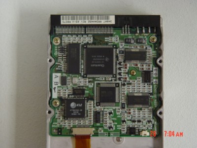

BlackST- thanks for your help. I have a question about what you mean by HW. Is that hardware, the configuration of the electronic board? Also, do you know which chip controls the spindle motor? I did a PCB swap before I posted this question. If it is the chip, do I need to find a working chip then replace it?

I have a 240AT at hand, the motor controller chip seems the HA13476, same for the LPS50. Can you post a pic of the controller board ? In any case, some part of the drive firm/software is stored on the platters (take it into account).

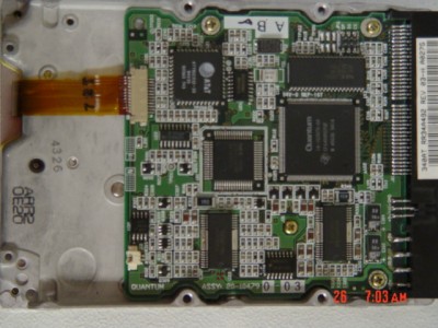

I couldn't get a closer picture of chips sorry.

You should have two HA13476 or similar ICs. (like RAM but with central tab for heatsinking) . Check them. Latter boards like the Fireball 1700AS have similar config. but a combo chip for VCM and motor drive.
A quick check should be easy - a short driver IC will become usually very hot at startup. Also, check for evident package cracks on the ICs.
BTW do the led show sign of life ? Have you checked the path from the +5 / +12 power to the rest of the board, quartz osc. and activity of the MCU (the syscon) ?
