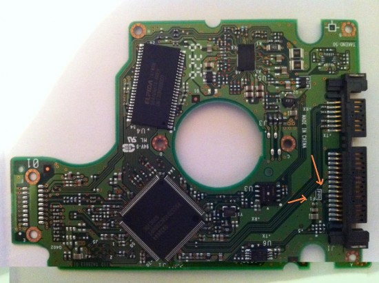

 Post subject: 2 HDDs failed
PostPosted: July 15th, 2012, 9:51
Joined: July 14th, 2012, 9:57
Posts: 10
Location: Colombo
Hey guys,
Recently 2 of my 2 Hard drives failed and they won't even spin up anymore :( .While looking for a solution,i found that it could be the TVSs which could be causing this.So i took the diode measurement of (what i thought were)the TVSs on both of my Hard drives
On my Samsung 1TB HD103SJ
The one circled red returns a value of 003 and the one circled blue returns a value of 739
On my Maxtor 160GB STM3160215AS
The one circled red returns a value of 003 and the one circled blue returns a value of 699
So what must i do to get my Hard drives working again?
Any help will be appreciated
 Post subject: Re: 2 HDDs failed
PostPosted: July 15th, 2012, 17:03
Cleanly remove them without causing damage to the surrounding components.
 Post subject: Re: 2 HDDs failed
PostPosted: July 16th, 2012, 5:40
Joined: July 14th, 2012, 9:57
Posts: 10
Location: Colombo
thanks for replying labtech,
do you mean both of the TVS or ???
 Post subject: Re: 2 HDDs failed
PostPosted: July 16th, 2012, 11:24
The TVSs, yes
 Post subject: Re: 2 HDDs failed
PostPosted: July 16th, 2012, 11:32
Joined: July 7th, 2010, 4:45
Posts: 924
If your lucky & this does work then just remember that they wont have over voltage protection so make sure you have a good PSU. If you want to continue using them properly then you need to solder replacement TVS diodes.
Loki
 Post subject: Re: 2 HDDs failed
PostPosted: July 28th, 2012, 4:02
Joined: July 14th, 2012, 9:57
Posts: 10
Location: Colombo
Thanks for all the input guys (sorry for being so late to respond)
In my case,i guess it would be better to get replacement TVSs. Can anyone advise me on how to get them?
(on the maxtor drive,the markings on the TVSs are "ST VU BUX GP744" and "ON QE R745" and on the Samsung drive, "ON pA06 LG" and "ON pA03 6V8A")
 Post subject: Re: 2 HDDs failed
PostPosted: July 28th, 2012, 5:25
Hrsda wrote:
Thanks for all the input guys (sorry for being so late to respond)
In my case,i guess it would be better to get replacement TVSs. Can anyone advise me on how to get them?
(on the maxtor drive,the markings on the TVSs are "ST VU BUX GP744" and "ON QE R745" and on the Samsung drive, "ON pA06 LG" and "ON pA03 6V8A")
Use the search function for keyword "digikey" and you should come across this store and other.
 Post subject: Re: 2 HDDs failed
PostPosted: July 28th, 2012, 5:44
Joined: July 14th, 2012, 9:57
Posts: 10
Location: Colombo
Use the search function for keyword "digikey" and you should come across this store and other.
could you please clarify a bit labtech?
i already searched mouser and digikey with those marking on the TVSs and came up with nothing
 Post subject: Re: 2 HDDs failed
PostPosted: July 28th, 2012, 6:06
Joined: July 7th, 2010, 4:45
Posts: 924
harddrive-without-tvs-diode-t21201.html?hilit=Digikey#p142043
Loki
 Post subject: Re: 2 HDDs failed
PostPosted: July 28th, 2012, 6:52
Joined: July 7th, 2010, 4:45
Posts: 924
Is also worth a read.
"Where can I obtain a replacement TVS diode?
Suitable substitutes for the 12V and 5V TVS diodes in 3.5" drives are SMBJ12A and SMAJ5.0A.
Depending on your locale, these can be purchased from ...
Mouser Electronics - http://www.mouser.com
Digikey - http://www.digikey.com
Farnell - http://www.farnell.com
RS Components - http://www.rs-components.com
Newark - http://www.newark.com
Note that the above suppliers have world-wide networks and local offices in many countries.
Alternatively, you can use any 12V or 5V TVS diode from a spare HDD."
 Post subject: Re: 2 HDDs failed
PostPosted: July 28th, 2012, 9:45
Posts: 339
On the first picture fuse on 5V rail is blown, then likely TVS in red circle is blown.
On second picture TVS marked red is visible burnt.
Don't remove a good one. meassure first.
 Post subject: Re: 2 HDDs failed
PostPosted: July 28th, 2012, 11:05
Joined: July 14th, 2012, 9:57
Posts: 10
Location: Colombo
Oops SAjunky,
I wish I had red your post first.i desoldered both TVSs on the hard drive in first picture and it still wouldnt spin up and i partially desoldered (at one end only)both TVSs on the hard drive in the second picture and it spinned up and i could read from it :) .
i had forgotten all about my previous diode measurement test :?
so if i bridge the 2 ends of the fuse in the first picture hard drive it should spin up right?
 Post subject: Re: 2 HDDs failed
PostPosted: July 29th, 2012, 1:03
Joined: July 14th, 2012, 9:57
Posts: 10
Location: Colombo
Okay,so i joined the 2 ends of the fuse on the first hard drive and it spun up too :D
Just one last question
What replacement TVSs must I buy? and what would be a suitable fuse to replace the blown one on the first hard drive?
(For the TVSs: im guessing 2 x 5V SMAJ5.0A since on the 2nd drive the blown TVS is on the 5V rail and in the first, the blown TVS is on the common rail between the 5V and 12V)
 Post subject: Re: 2 HDDs failed
PostPosted: July 29th, 2012, 19:46
Posts: 339
What I see, in both cases there are blown 5V TVS's (between 5V rail and ground). You need to look at your replacement of power supply, as it shoudn't happen, but you have 2 cases on 5V rail!
Reply came late, sorry. Glad both drives work now. :)
TVS replacement as per loki post. You need also fuse, it should be around 2-2.5 A. When replacing TVS make sure to put it in the same directions. :)
 Post subject: HOW TO REPLACE FUSE,
PostPosted: July 29th, 2012, 20:42
Posts: 184
Location: pakistan
i attached here pcb picture, F1 (fuse) was broken, i put here soldering wire, but the pcb is burn now, (with burning smell),
any advice for replacing FUSE, or any advice to put soldering wire against fuse,
OR i need ok fuse from any other pcb,
please
F1.JPG [ 176.97 KiB | Viewed 16371 times ]
 Post subject: Re: 2 HDDs failed
PostPosted: July 29th, 2012, 22:33
Replied to PM
 Post subject: Re: 2 HDDs failed
PostPosted: July 30th, 2012, 7:39
Posts: 339
Are you sure it was a fuse there? it doesn't show on the picture.
Replacing fuse with piece of wire is like not doing regular backup.
 Post subject: Re: 2 HDDs failed
PostPosted: July 31st, 2012, 7:59
Posts: 1768
Location: Verona, Italy
5 volt TVS Diode: http://uk.rs-online.com/web/p/products/710-3484/
12 volt TVS Diode: http://uk.rs-online.com/web/p/products/628-7629/
My firmware database:
Users browsing this forum: aggc123, Google [Bot], Majestic-12 [Bot] and 69 guests
