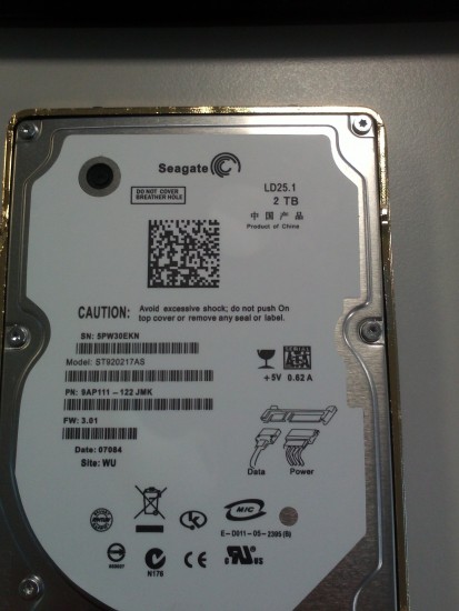

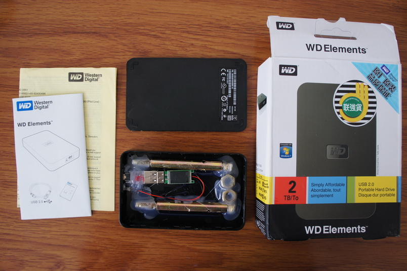

Hehe, another one like this:
or this:

Mi sa che trattasi di SOLA.... 8)
I have a feeling it is a FAKE..... 8)
 Post subject: Re: Toshiba canvio 2tb 2,5' usb 3.0 SERIOUS PROBLEM
PostPosted: August 29th, 2012, 5:30
Posts: 3551
100% a fake.
