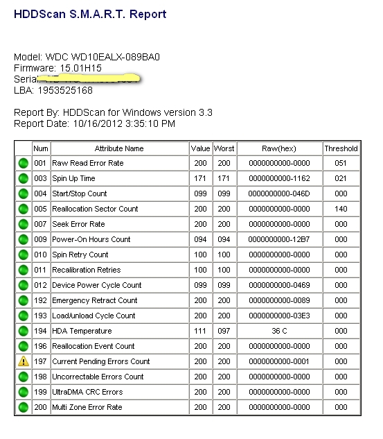

excuse me if I post on the wrong page, but i'm new here. I have a WDC WD10EALX-089BA0 for about a year now and i use it for storage. I run Windows XP SP 2. It all went fine until I noticed that the reading speed decreased. I observed this when I tried to play HD movies, 720 and 1080. What seams to be the problem? I know the OS is old, but I didn't encounter any problems until now.
Thanks in advanced for a possible answer and if you need more details, I'll try to tell them.

axelanti SAjunky already gave you two programs to diagnose the drive ! What is the make and model ? You can download hddscan from hddscan.com to check the SMART if any are yellow or red the drive is failing.

Yes it can be. hddscan is a simple SMART info reader it wont stress the drive. The full scan will stress the drive depending on the condition of the drive it could fail at any time. If you don't have a backup then ask yourself "why" data recovery is way more expensive than a $100.00 1TB drive which is why everyone suggest a backup before testing a drive that may be failing its just common sense and the safe thing to do. So what does hddscan show ? results

I have atached the S.M.A.R.T. result

Thanks for th info. For further reading go to this link at WD http://community.wdc.com/t5/Desktop-Por ... d-p/220704
