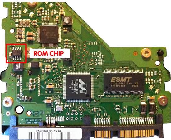

You can post a pic of the PCB, to help identify some general faults, but you will need the tools and skills to go any further.
A straight swap of PCB wont work,and you may need to transfer the rom too.
If the rom is external it may be easy, but in your case it may not be.

The HDD can’t spin. You can’t hear any noise or just hear a tick sound, which means the PCB is probably faulty.

It is written(etched) on the PCB. Remove the PCB and check.Post a pic of both sides of the PCB (to find any visible problems).
But you will need some electronic idea and proper tools to test and identify basic components.
Else you can replace the PCB (Have to transfer the ROM from the original to the donor)and check. And if the problem was with the PCB only ,then your drive will work(if you have managed to avoid all the DIY risks).But if there is internal problems(Can be possible) then you will have wasted money on the PCB
