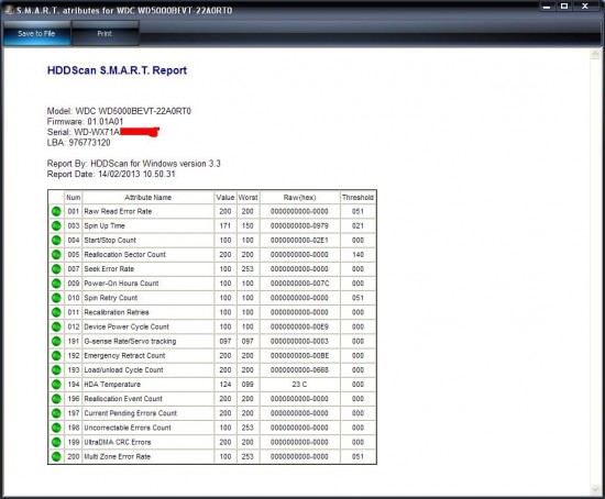

Barbarina wrote:
i've this 500GB Packard Bell USB hdd which has HPA activeted.
How do you know that this HDD has an HPA? Please explain the full history of this drive.

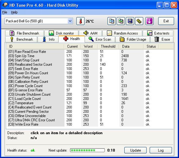

Barbarina wrote:
I suppose it has HPA on because it was connected to a HP motherboard and because has few sectors less then normal 500 GB hard drives.
Therefore this whole thread so far, is based on your guess of there being an HPA, but you previously stated it, as if it was a fact :( Actually there are at least 3 other possible causes which I have seen in the past, so there may not be an HPA. Please make it clear when you write, what is a guess (or assumption) and what is a fact. Thank you.
Barbarina wrote:
I don't know if inside it's a sata drive, i suppose it is.
Again, you are guessing - for example, some drives have USB built-into the PCB and they have no normal SATA interface connector. This is why I was asking about the disk's make & model.
Barbarina wrote:
I don't know how to discover which kind of drive is inside without opening the enclosure.
Maybe hd tune? I will try...
I don't use HD Tune. Personally I would use the Smartmontools package (which is available for Windows, as well as Linux etc.) and collect the "smartctl -a" output, which includes the SMART data in an easy-to-read format, as well as including the identification data from the drive. Please provide that output. If you have big problems with that (there can be reasons), then HDDScan can be tried, to get that information.
Barbarina wrote:
i don't know where to find usb host controller and dos drives, can you help me?
No, as this may be a waste of time. As I said before, using MHDD with USB drives is not something I recommend, as there are many limits when used in that way (for reasons too long for me to write now - read about the USB mass storage protocol to learn more). I was asking you to explain why you said MHDD doesn't work with USB drives, and again, I see that your original statement was a guess and not something you had actually tried with this drive, so you have now answered that question, thank you.
So in summary: If HD Tune doesn't show the necessary details about the drive, please provide the "smartctl -a" output [you may also need to use the -d option - read the documentation] (or the HDD Scan output) showing the drive identification and SMART data. Also please answer my previous question - what is the full history of this drive? (e.g. is it from a customer?; was it recently bought in a shop?; has it been used successfully for storing files for a long time?; do you know that it ever reported a larger capacity, or is it possible that the currently reported capacity is what this drive has always reported? etc. etc. - any information which may help the readers here to understand more).

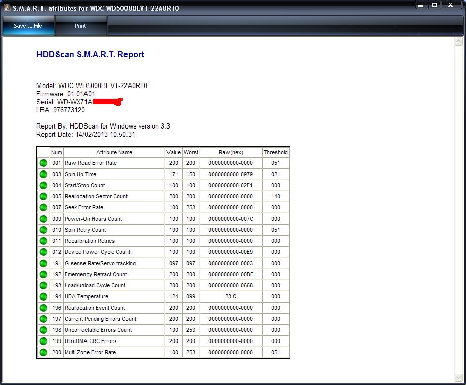

HDD Scan:

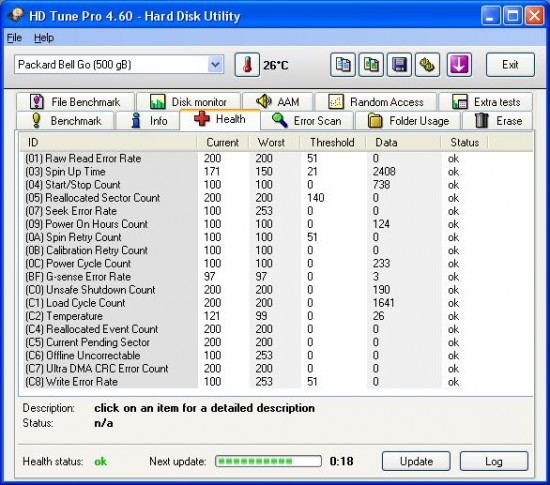

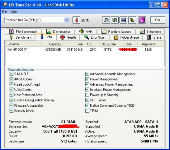

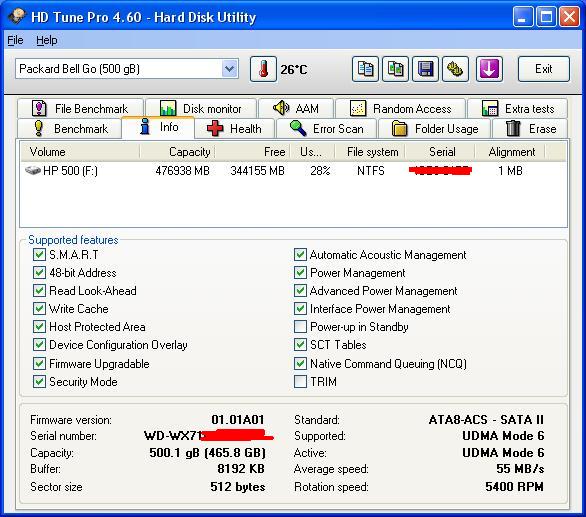

HD Tune:

Your second picture shows HPA is set & the data output from smart shows the drives interface is SATA
A quick search on google confirms this:
http://www.pchub.com/uph/laptop/645-817 ... 500GB.html
If you remove the drive from the caddy & connect it up via the sata to a PC then MHDD should be able to remove the HPA. Remember that the BIOS setting for sata needs to be changed from enhanced to ide or compatible.
Obviously opening up the caddy to remove the drive would void any warranty

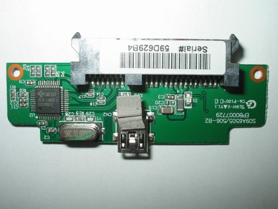

I opended it and connected via sata.
Mhdd detects it but the HPA light is off and it shows full capacity :?
This it means that the drive shows limited capacity (only 46 LBA less) only when is connected to the packard bell usb-sata adpter, i don't know why :?
If i clone my seagate into this western digital (sata connection) and after i put the western digital again in his enclousure, what will happen?
I will lose data (or part of it)?
On the usb-sata packard bell adapter it's wrote:
S09A6505/506-B2
EPB0007729
On the U2 chip it's wrote:
JW8509
1015 LGBA0 A
U3 chip:
93c46vi
(which is a 1-Kb Microwire Serial EEPROM)
On the enclosure:
LC.EXH04.015

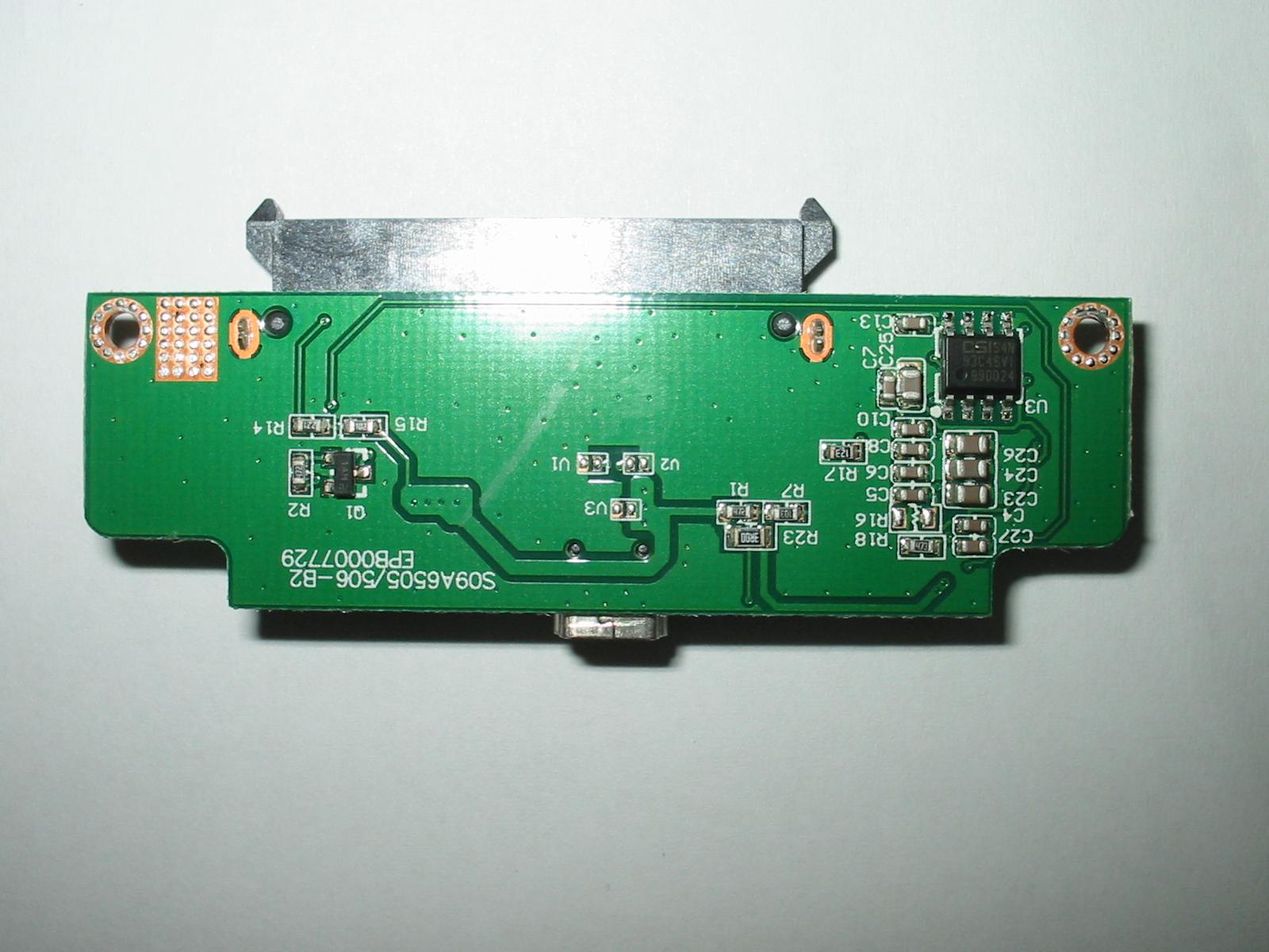

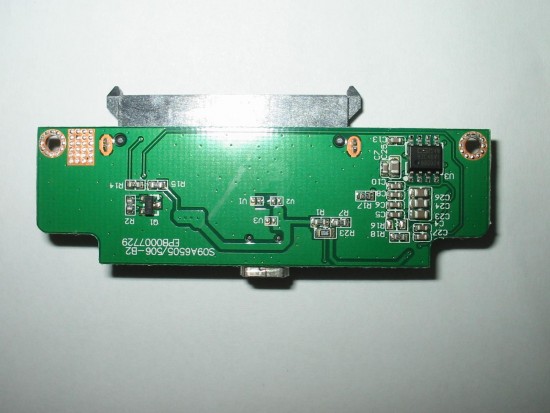

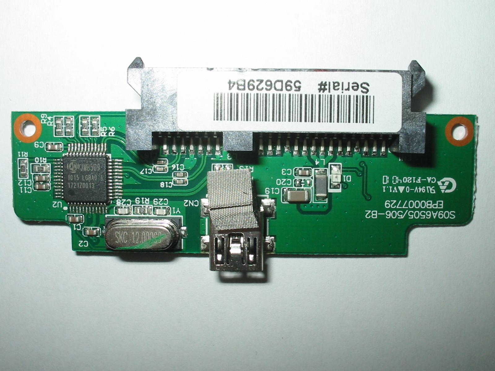

Thanks for the photos.
JW8509
IMHO I don't think it says that - I think it says JMB509 which looks like a JMicron part. I haven't seen that specific number before, but perhaps someone else may have seen it before, or have more time to research it for you.
 Post subject: Re: Packard Bell USB drive - HPA delete in MHDD, how?
PostPosted: February 14th, 2013, 12:20
Banned User
Joined: February 5th, 2013, 15:40
Posts: 16
Location: Italia
yes is JMB509, my camera has better eye then me :lol:

Spildit wrote:
2nd picture shows that the drive supports HPA, it doesn't mean that it's turned on :)
True but when you also look at the smart data picture under Enabled command sets Host protected area is listed :)
