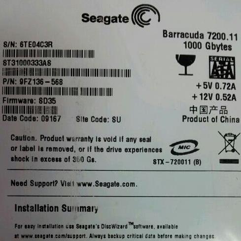

ST31000333AS
Firmware: SD35
No spin. Beeping Sound.
I can terminal to the drive but fail to make any headway beyond spin down with the board physically separated from the drive.
Plz help
Update:
ASCII Diag mode
F3 T>/2
F3 2>Z
Spin Down Complete
Elapsed Time 0.106 msecs
F3 2>U
And the beeping returns It's been over 3 minutes and nothing new has popped up in my terminal session. Thoughts?
Update 2:
Finally something popped up and the drive stopped beeping:
DiagError 00006008
Spin Up Error
Elapsed Time 6 mins 58 secs
R/W Status 2 R/W Error 84150180
Anyone knows the right diagnosis?
Is there anything that can be done to fix it?
Thanks!

If your drive does not spin and emits beeping sound, I would go for spindle, but you need to open the drive and check that manually.

I would vote for spindle too and if that's the case, you have quite a mess in your hands...
If you don't mind sending the drive, I'd be happy to take a look.

This can easily be a pcb problem, probably the smooth motor chip.
Try to get a good working pcb and swap the 25p40 flash rom chip from your bad pcb into the good pcb, but if doesn't work it means the issue is internal.
 Post subject: Re: Seagate HDD failure. PLEASE HELP!
PostPosted: December 22nd, 2012, 19:44
If the drive buzzes, it is not a PCB issue.
Let's cut to the chase. 90% or higher chances are the drive has a spindle issue. There is not much you can do on your own to recover the data. If you want a solution that professionals use to recover data from failures such as your drive's, then check this link: http://www.hddsurgery.com/tool/hdds-spi ... 7200-10-11
This is the kind of tool necesary to attempt data recovery. But that is only let's say 70% of the battle, as there could be other issues besides the spindle itself.
There could be one small rare exception where the failure is much more delicate where that tool is not necessary, but then still have to check manually, and it involves opening the drive in a cleanroom environment, and having some skills to be able to examine and address whatever issues there may be.
If you want to fix it, then you are wasting your time. Just trash it. Not worth the time or money.

Maybe i understood what are you talking about.
To know if the motor is stucked or not, simple shake the drive clockwise and counterclockwise quickly with power off, if you feel the platter move a little bit is ok, if you dont feel no movement the motor probably is stucked.
Am i right? 8)

Not all Seagates. It depends on architecture.
The Green series is similar in design as .11

If the drive don't spin up it's bad Pcb or more likely stucked spindle...and in very rare cases sticktion.
Get a Pcb that match, if it spins up it's a bad Pcb, if not stucked spindle or sticktion...both cases not DIY.
