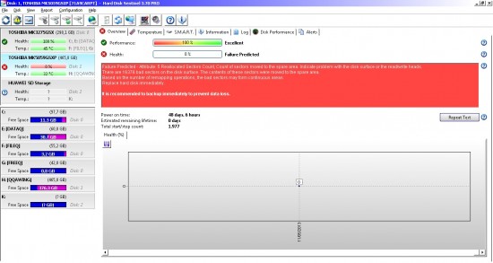

 Post subject: What causes this case?
PostPosted: March 25th, 2013, 0:29
Joined: February 29th, 2012, 21:37
Posts: 41
Location: indonesia
What causes this case? anyone give me explain about my pic?

Looks like a failing head or the drive has a scratch or other media failure. Entropy is a most frequent culprit . . .

The drive is an Advanced Format model:
http://storage.toshiba.com/storagesolut ... sxp-series
A Reallocated Sector Count of 16376 looks much too big to be real, but if you interpret it as a Reallocated LBA Count, then the actual number of reallocated physical sectors is 2047 (= 16376 / 8). In hexadecimal that equates to 0x7FF. To me it looks like the drive may have maxed out.

but a LBA=a sector

An LBA is a logical sector. For compatibility reasons, an Advanced Format drive still emulates 512-byte sectors. It's called 512e.
this HD can still be used to read data takes a long time, i've formated with LLF but no change
That is a big warning sign to you.
Yes, of course, that is a normal result for the likely types of problem which jono-ats kindly explained to you. Since you don't need the data from this drive, then there is no point in any further DIY attempt, so just replace the drive.
I can think of one other, less likely, possible cause for the very limited info you have given - but the easiest test for that hypothesis is just to replace the drive, and make sure that similar symptoms don't occur again with another drive.
