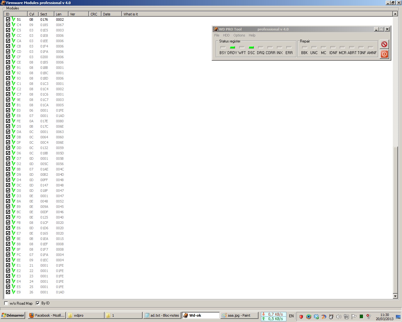

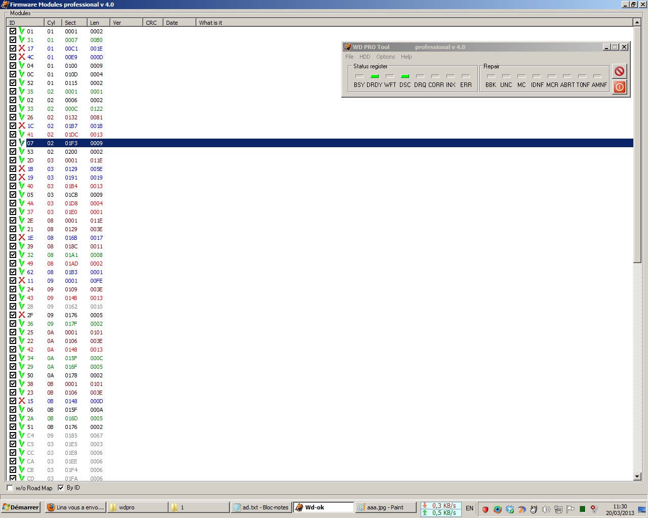

after testing the modules (I/O >> check all by id) i found out that those have defects .
17 - FM_ERR_COMPAT
4C - FM_ERR_COMPAT
1C - FM_ERR_COMPAT
1B - FM_ERR_COMPAT
19 - FM_ERR_COMPAT
1E - FM_ERR_COMPAT
11 - FM_ERR_COMPAT
2F - FM_ERR_COMPAT
15 - FM_ERR_COMPAT

extracted and now in the module window , i do right click on the bad modul >> I/O >> write multi selected and i choose the same module from the donor downloaded FW "with extension .mod" to get
No Module: 0 in Map
a friend has sent me his backup ".rpm" and each time i select replace my module by the donor one , i get
Write Module: **
where ** is the module name
after finishing i repower the drive and re do all the previous to find that the bad modules are still there !
can any 1 of these drive's modules replace the bad onces on my drive ?

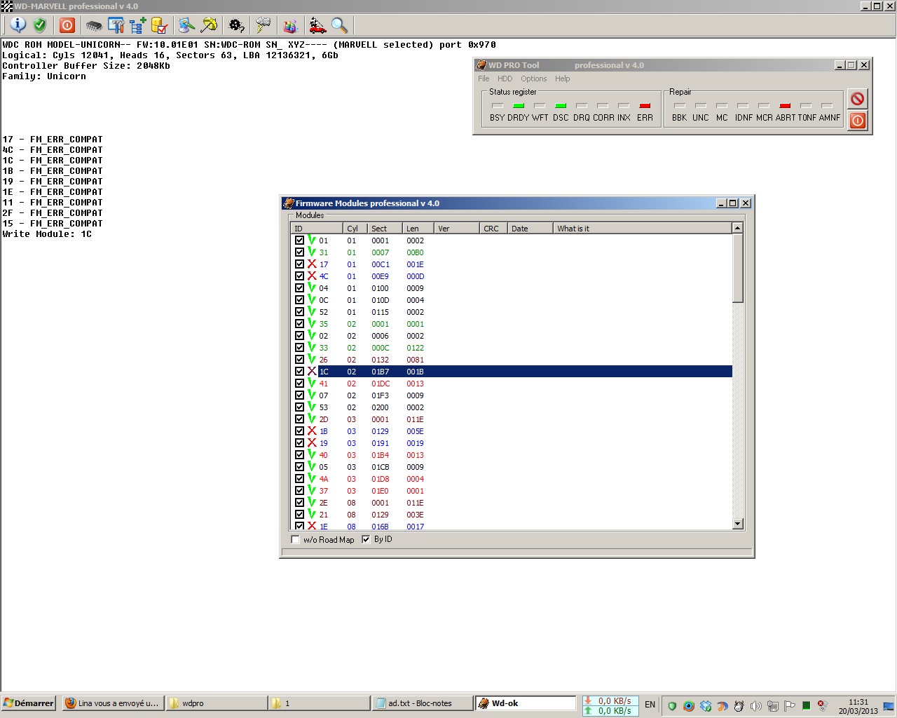

hello again , i am attaching photos .

XYZ is a symptom of some failure, not a fault in itself. Your problem is somewhere else. Assuming ROM is OK and is transferred to known good compatible PCB, and no other faults with the disk, then you should reach ID, which you dont, meaning you very likely have other problem elsewhere.
 Post subject: Re: wd800jd pcb swapped 3 times with the same error !
PostPosted: March 21st, 2013, 9:28
Joined: August 22nd, 2011, 15:43
Posts: 209
Location: Romania
Spildit wrote:
I don't like that XYZ at the ROM version.
My 128k wd patient shows also something like: BUCCANER WDC-ROM SN# XYZ----
It's the default way to identify when the rom firmware is good but there are some problems with the SA modules (cannot read SA..or modules corrupted..or incompatible versions of modules etc)
The header of each module has a flag...which shows that the module should be checked against the rom firmware. I have no idea what this means...but if it fail the checking it throws that FM_ERR_COMPAT ...perhaps it looks at the versions (rom vs module). I have to investigate since I must implementthis at some point in my app. So any ideea what it means that cheking would be nice :)
The CRC it's ok..but the module it's not for this rom version (or reverse). And the kernel shows WDC-ROM SN# XYZ---- and stops.
If the SA is damaged for some sectors..then there will be another type of errors...when reading those modules. The same for writing. If the write doesn't throw errors then there are no defects on that region of the platters.
LE:
open those mods with a hexeditor and look for bytes 5-8..and 9....
    int version;         // [Bytes 5:8] The version number
    byte compat;         // [Byte 9] This byte is checked against the ROM to ensure compatiblity
I assume that the byte 9 it's set somehow..then the version bytes must match the rom version.

Spildit wrote:
I can see ERR and ABRT when you try to write module back .....
then why doesn't rapport anything in the log window? usually when you can't write...the corresponding VSC command throw an error which should be interpreted by the software and shown to the user. those red dots are just for fun.
btw, wdr 3..gives me ok on all 4 heads with "read test" on SA. in fact..i just discovered that head 1 is dead. so it suckz. and booted again in xp..to test again. definitely show ok ok ok ok an all 4. but see the image I've posted.
I explained what FM_ERR_COMPAT means. I have doubts that the firmware will report this err...having behind a read problem. because a bad sector means problems when reading..bad crc...so it should report error_reading...not the result of a compatibility test which assume that the reading was ok...but the check against rom failed.

Spildit wrote:
Read my last post.
smart Hot swap DID WORK on this case and all data was recovered with success !
I've checked this drive with the OP by Skype/Screen Sharing.
Sorry, i readed badly.
