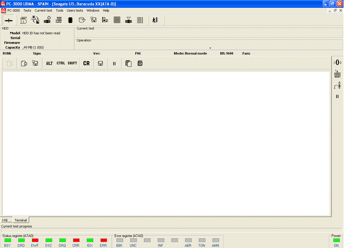

I have here a ST 7200.10 Bricked Drive.
I think ROM BRIKED.
Tha HDD do not start, and see Picture to PC3k status.
Any way to upload FW to ROM?

Pic here

Spildit wrote:
Doesn't it spin at all ?
Try to insulate the contacts to the head stack and see if it spins.
Anything on terminal ?
This will exclude a shorted pre-amp.
Does the pcb have a ROM chip ? Do you have external eeprom programmer ?
thanks Spildit for your quick help
Nothink
I try it, but not spins
no, Nothink on terminal
Yes have it a ROM, but i have not external programer

Sure PCB is good?
