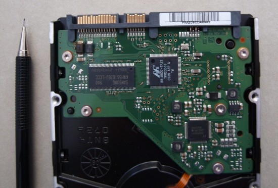

this weekend I used the wrong Voltage on my external HD. It was (unknown to me) set to 19V instead of 12V).
Model: Samsung HD103SI (1000GB/R54/32M)
So all I want to do it access the drive, remove the data, and throw the thing away. I have read in a few threads, that I could remove the diodes, plug it into my PC and maybe this would bring the thing back to life.
Is this really true?...I can see that the one diode is light brown. There is also the burnt smell lingering as well. So it´s definately a short circuit. I have also tried to find another HD which has the same Model number and part number and can´t find one anywhere. This is where things start getting complicated. Before I invest 1000´s in data recovery and buying replacement gear that doesn´t match the HD, I just want to ask whether taking the diodes (or just one of them) out and connecting to the pc might work without causing more damage?
your,
Rob

please make photo of your PCB and publish it here
BR Jure

Hi...as requested, my HD Photo:

Also, publish the picture of the PCB here.
So we can check the diode's, if has external ROM, etc.

Sorry.... just read the OP initial post..... If the drive has come from an external casing and the failure is indeed as described, then removing the TVS's should be OK as long as you know that your PC PSU is operating correctly....
Best practice would be to replace the defective TVS's ..just in case...

SUCCESS!!
Thank you for the replies. I removed the burned out TVS Diode and the HD started without a problem. I´m copying the data as I write.
What should I do with the damaged HD? I suppose I could solder a new TVS in it´s place could´nt I? I´ve never done it myself, but It seems a shame to throw away an HD when it works ok.
Can you buy these diodes over the internet?
