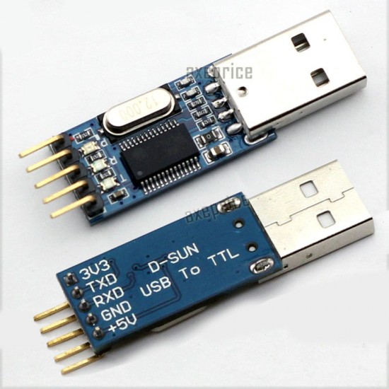

you don't say what your adapter is
Here is a picture of my adapter.

I cant see the cip but looks to me like a PL2303 I had issues with one of these, but I think it was related to drivers, cant remember now.
I would buy a different one, something like "USB to TTL Converter Module Adapter with Built-in CP2102 Chipset" or a CP2103.
Also, you shouldnt need to "try different Com Ports" You should plug in your device, go to device manager, see what the com port actually is, and use that. If you want to continue with this adapter, make sure you have latest drivers. Windows might guess a driver and install it, and it may work with some things, but go to the driver page of the chip manufacturer and download the correct one. Re-Install, and make sure you uninstall the old driver first, and choose "also delete current driver software" or whatever that option is.

My adapter name according to ebay is USB To RS232 TTL PL2303HX Auto Converter Adapter Module for arduino. (http://www.ebay.com/itm/New-5PCS-USB-To ... 4637wt_827)
I use the following prolific driver: http://www.prolific.com.tw/UserFiles/fi ... v1_7_0.zip.
I will try to search in google and updated driver for that chip. But i think that if work with 7200.9 would work with 7200.11 too.
