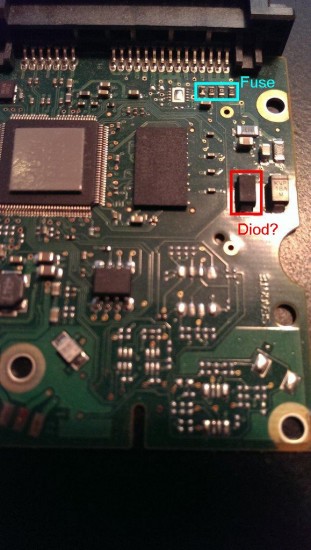

 Post subject: Seagate ST1000DM003 Stopped Spinning Up
PostPosted: December 9th, 2013, 6:17
Joined: December 9th, 2013, 5:47
Posts: 7
Location: United States of America
It happened at the same time as my power supply failing so I'm assuming they are related. It makes absolutely no noise and I feel no vibration when I give it power. From some extensive googling it seems like my problem might lie with the TVS diodes however unlike many other cases I've seen mine do not have any visible burn marks or damage of any kind. There is a very tiny amount of discoloration on two of the ovals that make the contacts but I doubt that would matter.
I do not know how to solder but if it means avoiding paying out the a** for professional repair/recovery I'd be willing to learn in the event I need to transfer the rom chip or whatnot. One question I had is could I just remove all the diodes just to see if it worked or would that damage it? I know it wouldn't have the overvolt protection but I'm only trying to get it working long enough to transfer my data off of it.
I'm linking to an external gallery for pictures so it doesn't clutter up the page. Hope that is ok. http://imgur.com/a/vD9TK

This Diod looks suspicions, but I am not 100%sure. If that is a Diod, then the fuses would have shorted out also. The diod will need to be removed, and the fuses shorted to allow power through. However, I would not recommended and circite board swap or ROM swap if you do not know how to do it. A Professional assistance should not cost much in this case.
Shane

A fuse is just a solid link, that is designed to "blow" at a certain specification. so you can just replace it with a wire, but you remove the protection it gives and whatever problem blew the fuse in the first place could now damage other things. The "problem" could have been an external source, so you may be lucky and the wire will work long enough to get your DATA, if it is the issue.
So, if you have a multimeter, then check the continuity of the fuses. If you don't know what this means, then figure out how to set your multimeter to continuity test. If you don't have a DMM(digital multiMeter) then you can get a cheap one that will suffice for less than AU$30. Now, touch the 2 (red & black) probes together. it should give an alarm. The same alarm should sound when you test the fuse. Put a probe on each end of the fuse.
if any fuses are open, you won't hear an alarm and the fuse is "blown". Now turn your attention to the Diodes
 Post subject: Re: Seagate ST1000DM003 Stopped Spinning Up
PostPosted: December 9th, 2013, 22:42
Posts: 17214
The diode highlighted by ShaneWard is the 5V TVS diode. The component to the right of it (KVP) is the 12V TVS diode.
The two leftmost zero-ohm resistors ("fuses") are associated with the 5V diode, while the two on the right are associated with the 12V diode.
ISTM that the leftmost fuse looks blistered, but that could be just the lighting.
IME in this forum and others, flowing blobs of solder over each of the open fuses, and snipping the shorted diode, is all that is required. In fact I recall that someone who tried to swap the flash memory chip (in this forum) only suceeded in damaging it, with disastrous consequences. If you intend to take the DIY route, and if you are a novice, then IMHO the path of least risk would be to bridge the fuse.
That said, you must ensure that your PSU is good, otherwise a second overvoltage will kill your now unprotected drive.

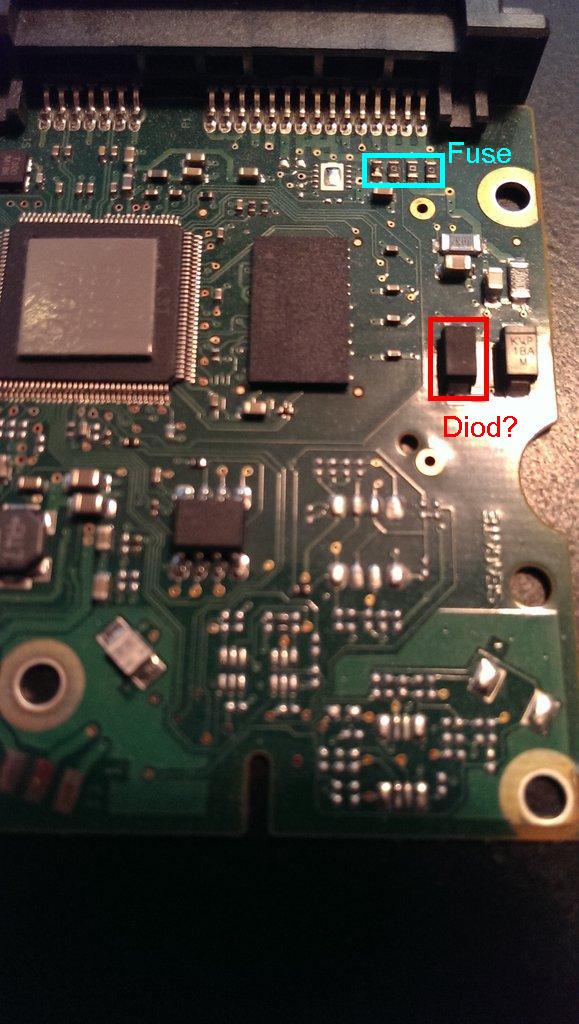

Ok I got some better pictures of the fuses you guys are talking about. http://imgur.com/a/jzfPu/
I did replace my PSU and I'm 99% certain that was the cause because I leave my PC on 24/7 and one day I came home and it was off and wouldn't boot. However when I replaced the PSU and hard drives it was fine so from what I can tell the PSU failed and blew some fuses/diodes on both of my HDDs. Somehow the rest of my system was fine.
Now that you can see the fuses better can you tell for sure this problem is only related to the PCB or is there another mechanical problem that could cause the drive to just not do anything? If it is for sure the PCB then I found a site that will switch my ROM chip with a new PCB for a flat fee http://www.donordrives.com/ I'd rather just have them do it so I don't have to go out and buy soldering equipment and then possibly break my PCB or something. Anyone know if that is a reputable site?
PostPosted: December 10th, 2013, 3:58
Posts: 17214
They do look bad, but measure them and the diodes before you do anything.

I borrowed a multimeter and tried measuring them before but I didn't get where I was supposed to put the leads on the diode to measure it. I tried putting it on the top of the metal part next to the black plastic thing and that got me a measurement but if I moved it a bit it would start fluctuating a lot and beeping. No idea what that means. I guess I could borrow it again but I'm gonna need a more dumbed down/specific explanation of what I'm supposed to be doing.

The quick way to see if these are the problems is, snip of the diod I highlighted in red. You won't need it if its blown, and find a way to connect the two sides of the fuses together to allow power through. Normally soldering a blob across the contacts would work, but you can allways take it to your local electrcal shop who does soldering and they can do it for you.

I borrowed a multimeter and tried measuring the diodes before but I had no idea what I'm doing. I'd seen that guide somewhere else and tried following it but I still didn't get where I was supposed to put the leads on the diode. I tried putting them on the top of the metal part right where it meets the black plastic bit and I got a stable reading in certain places but if I moved a millimeter it would start wildly fluctuating and beeping so I have no idea what I was doing wrong. Could you elaborate on exactly how you measure them and the fuses?
What exactly is "snipping the diode"? Do I just cut/take off the black part or do I actually have to cut the metal piece under/inside the plastic? I don't really know what it looks like under the plastic thing.
