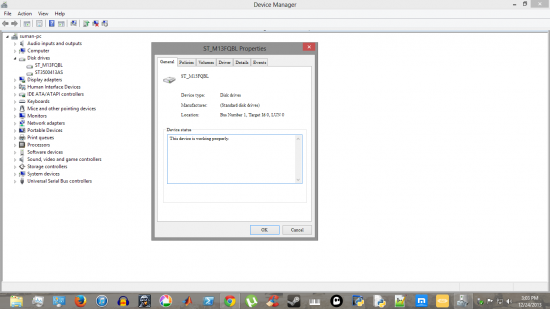

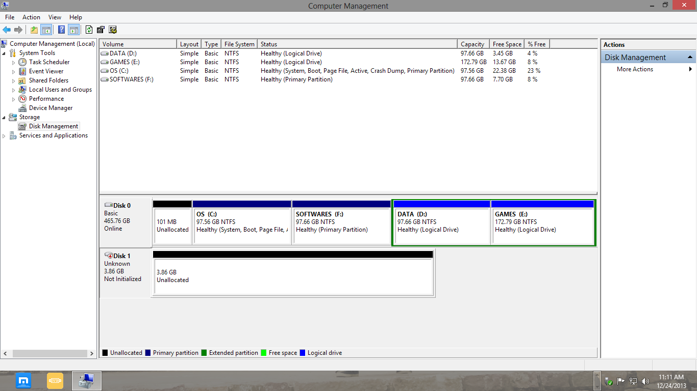

i recently added a internal hdd of my friend on to my system..
it seems to not get recognized...
disk 1 is the new one..
i am getting a i/o error ..when doing intilization..
its filled with data..could some one help me over here..i dont want to format it .... :cry:
but if its the last thing to do ..plz ..give the very basic stuff to do that because i am a newbie...
Any help would be greatly appreciated.. :D

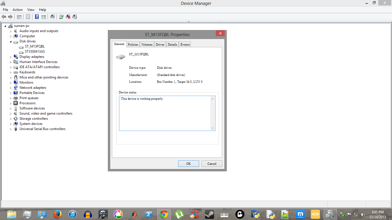

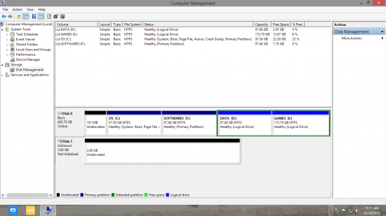

what kinda ..a informaion really...?
when i open my computer..only my previous hdd gets recognised and i am ale to access ans see it ..while my second (new one)..i cannot see it..it says the new one is working properly..no problems ...

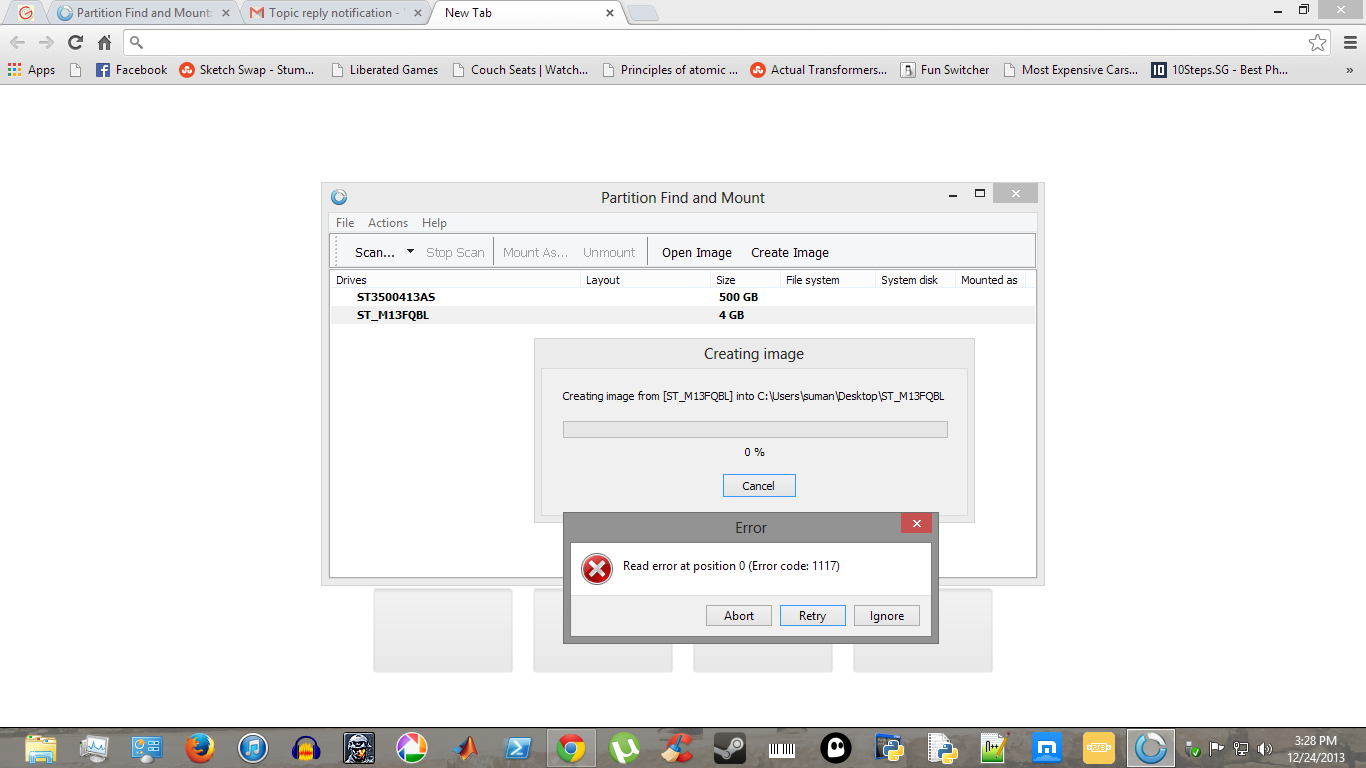

Hi, try "Partition Find and Mount" http://findandmount.com/
once it has scanned the disk, then I would suggest to choose make an image of the drive.
Is the drive actually 4GB?
once you have an image, you can just mount the image(it will show up as a drive, say V:) you can just copy files, or if the image wont mount, perform data recovery on the image.

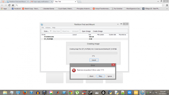

tried find and mount ...no use ..getting errors...

its actually a 500 gb hdd now showing only ..about 4gb ..dont know ..why..?..i am a newbie to all these... :oops:

it is actually a 500 gb hdd ..but now showing ..only ..3.86gb unallocated and not intililized ...
