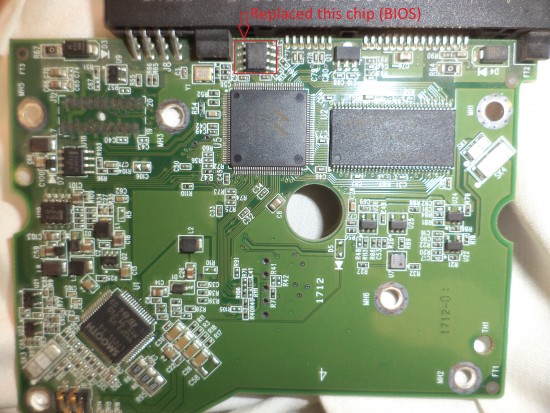

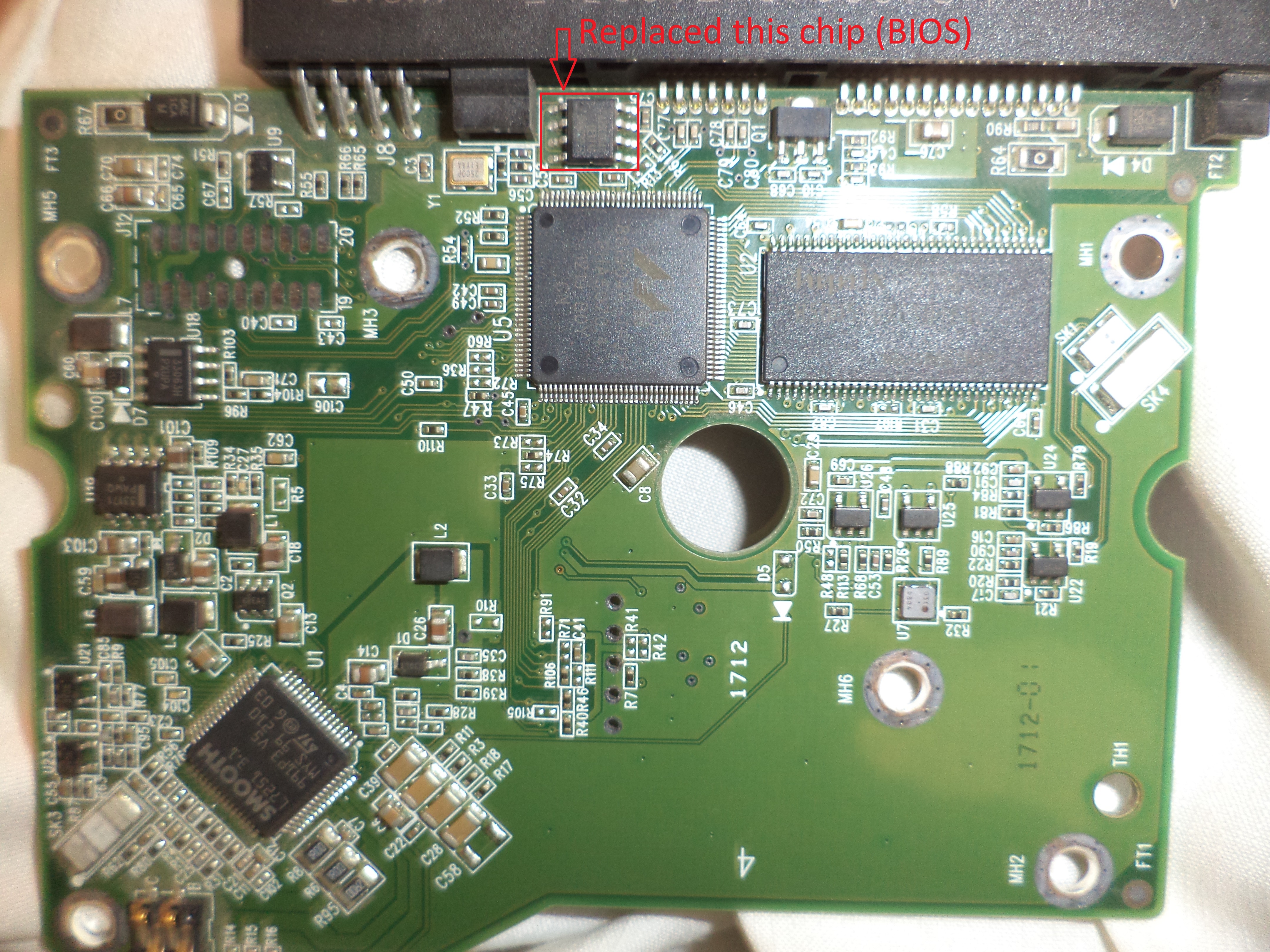

 Post subject: Re: WD HHD Problem
PostPosted: December 26th, 2013, 12:33
Joined: November 29th, 2013, 3:49
Posts: 6
Location: Pakistan
i tried new PCB with bios swap but no use. same condition not spinning up and showing 0.0gb in BIOS. any recommendations. I have attached the picture of PCB, there is pointer pointing towards replaced chip. Any more chip that has to be swap.
File comment: PCB
PostPosted: December 26th, 2013, 18:22
Posts: 17214
ahmad21 wrote:
I have attached the picture of PCB...
Clean the HDA contacts.
PostPosted: December 27th, 2013, 1:04
Posts: 6
Location: Pakistan
Spildit wrote:
Did you try the donnor pcb with the donnor rom (without rom swap) ? Does it spins that way ?
Insulate the head contact on pcb with a piece of plastic foil. Does it spins that way ? If so pre-amp inside the head stack is most likely shorted.
Do you have any tool like wdr, salvation, etc ?
Yes i tried that way also but no use, same condition not spinning. No I have no tools. But there is a person who have PC3000 only. Actually i am not the professional specially for hdd and also there are no hard drive experts in my country. I live in Pakistan.
