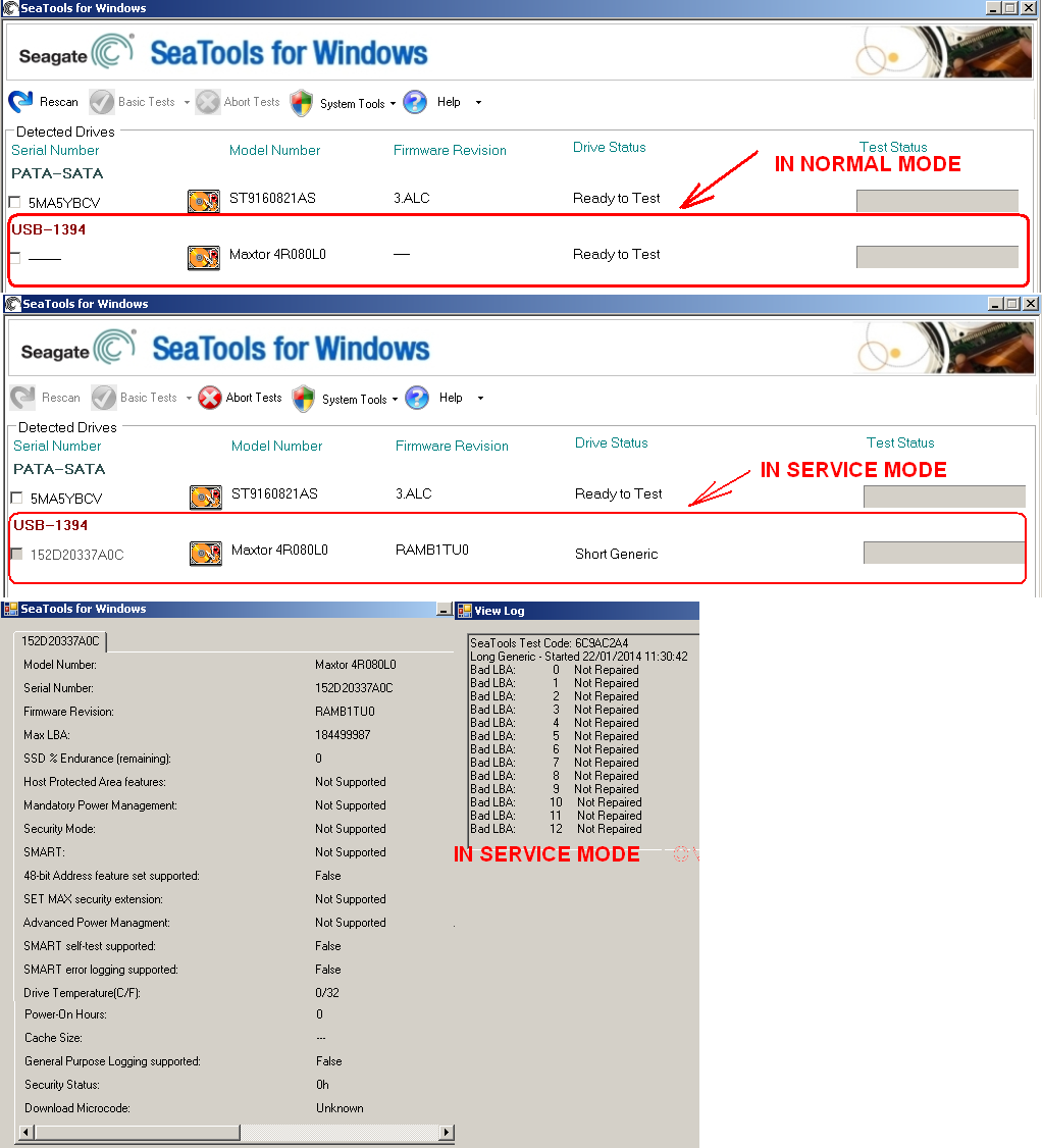

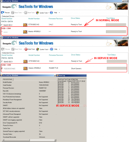

Need expert advise. Maxtor diamondmax16 does not identify itself in normal mode. Disk spins and all sounds are normal. When jumper switched to service mode it does show up. Here attached is image how it is seen on Seagate tool on both service and normal modes.
I suspect it is symptoms of firmware problem on the disks service area. Can somebody confirm this?
And if so what it the way and tools to fix it?
I've seen PC3000 and Salvation could put loader and fix firmware. Is there any alternatives to them?
Disk:
Maxtor DiamondMax16
RAMB1TUO
4R080L
N,F,G,D
Maxtor Screen

Could you give more detais how this feature works and looks. I'm going to have access to legal PC3000
Re: Expert advise needed - Maxtor DiamondMax16 frimware?
January 22nd, 2014, 10:27
Model is defined correctly = Maxtor 4R080L0 so the loader is not required
January 23rd, 2014, 10:03
From what I see the drive comes ready flawlessly:
1. Correct model shown (drive is not in the safe mode)
2. Correct FW shown (overlays are loaded)
3. Correct SN and size shown (DISK module is loaded)
4. Drive is able to show SMART (SMART modules initialized)
That said, the percentage of probability the drive has bad translator modules is very small
So I would probably think that drive has unstable heads(more likely) or incorrect adaptives module (less likely) and that's why it has read errors
Att # 201 : Unknown : 253 252 52 <-Off Track Errors
Att # 202 : Unknown : 222 222 49 <-Data Address Mark errors
Att # 203 : Unknown : 249 249 3463 <- ECC errors
