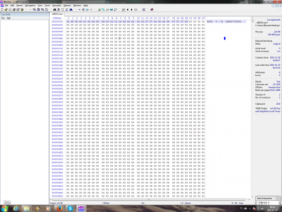

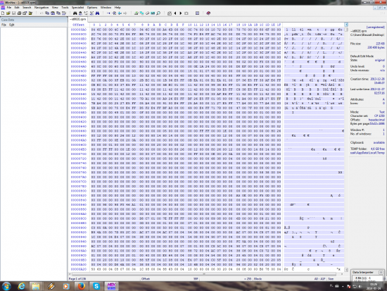

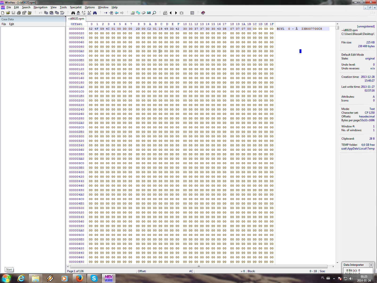

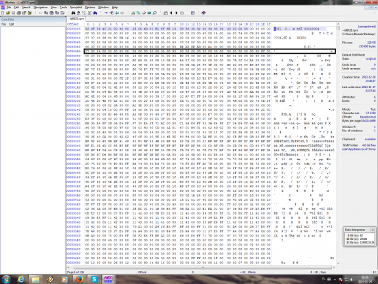

January 23rd, 2014, 20:13
ok, i was opened modules 2D and 2E in hex editor
and what's next ?
Re: Need ROM of WDC WD10EADS-22P8B0 ._01.00A01
January 23rd, 2014, 20:20
mmm... :roll:
looking mask ROYL.
January 23rd, 2014, 20:27
ok, so
result is in attachment:

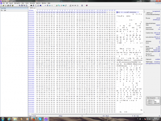

January 23rd, 2014, 21:20
and you know what your looking for?
length(mod_2Eh)=016Dh see throughout the unit.
p.s but it is better to give a professional

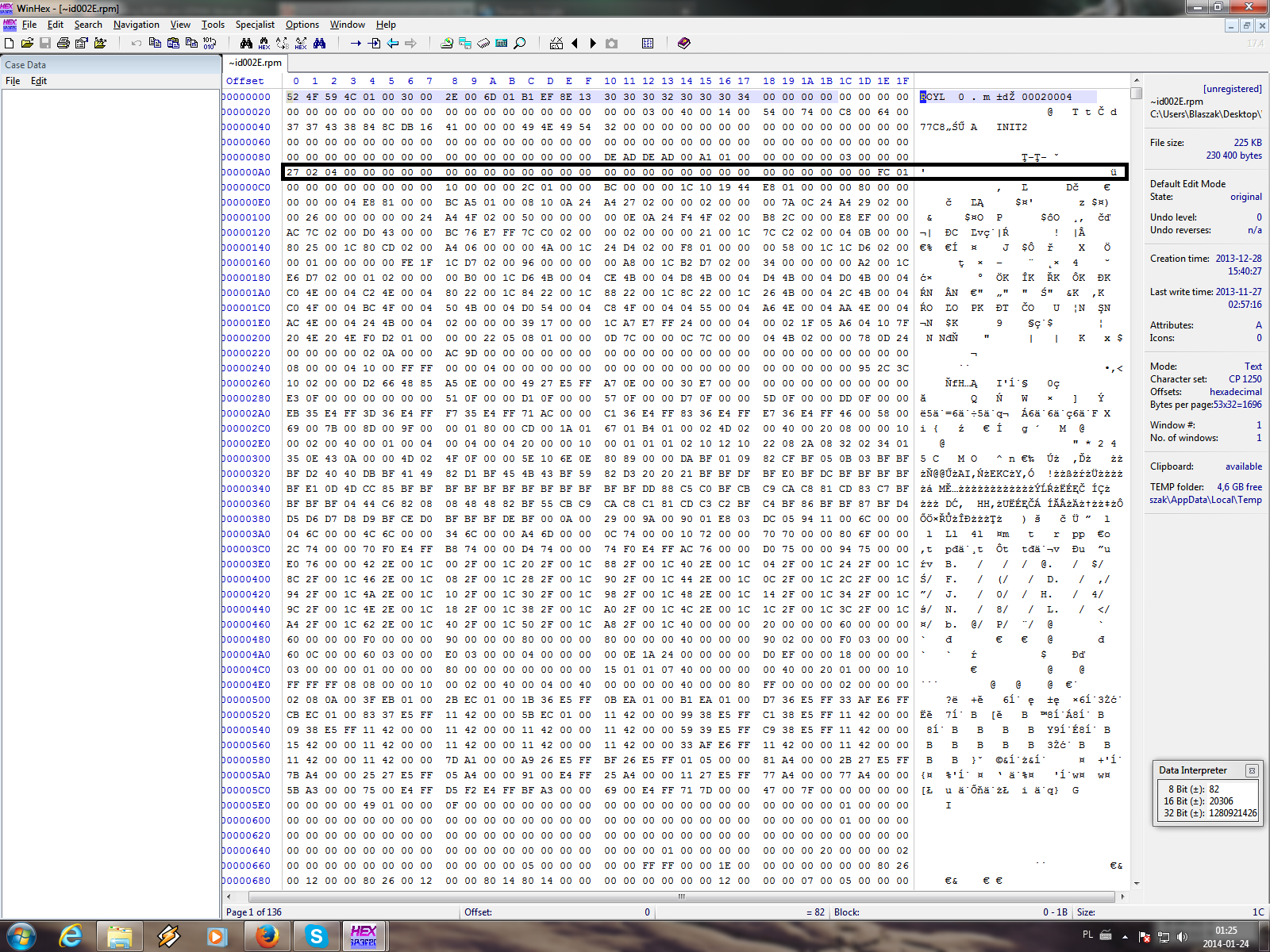

January 23rd, 2014, 21:44
Hmm, I'm sorry, but I can not find 016Dh, I can attach a module 2E and colleague he will verify this value!?
so the easiest way is to write in order to give a professional, but I'm sorry I can not afford such an expense up. Therefore, I try to act on their own with the help of sympathetic people here.
~id002E.rar
(66.99 KiB) Downloaded 463 times
January 23rd, 2014, 21:55
offset 000Ah. = length(mod).
need to look for signatures ROYL. (around modul there will be several).
I do not understand English, you little knowledge of HDD. we can not
understand each other. Sorry.

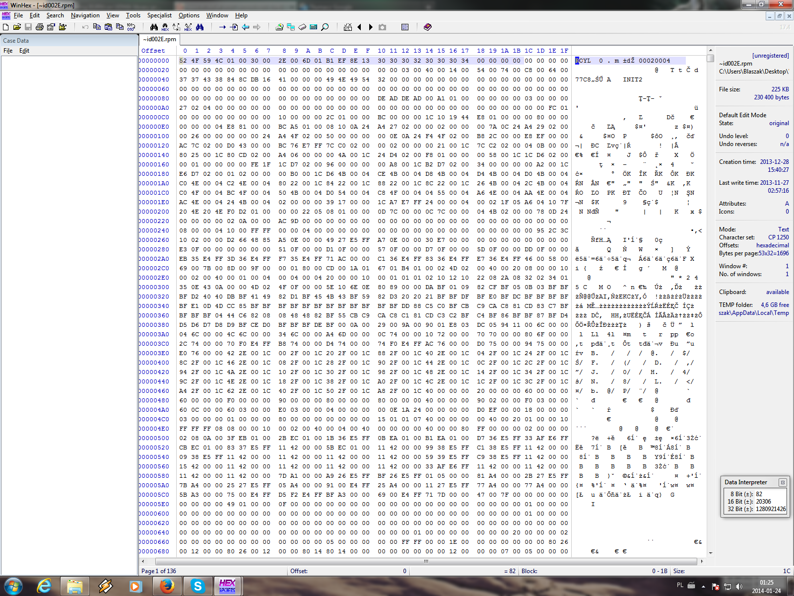

January 23rd, 2014, 22:05
yes it's true, because I'm a sissy in these blocks we simply ask for help. attachment result:
My english is based mainly on the google translator, because I come from Poland and thin with me English. So something is not clear then please write. Regards! I thank you in advance that a colleague wants to help me.
January 23rd, 2014, 22:12
2Eh long module. 016Dh=365dec blocks. Why do you show me his start?
p.s.00A0h =/= 000Ah.

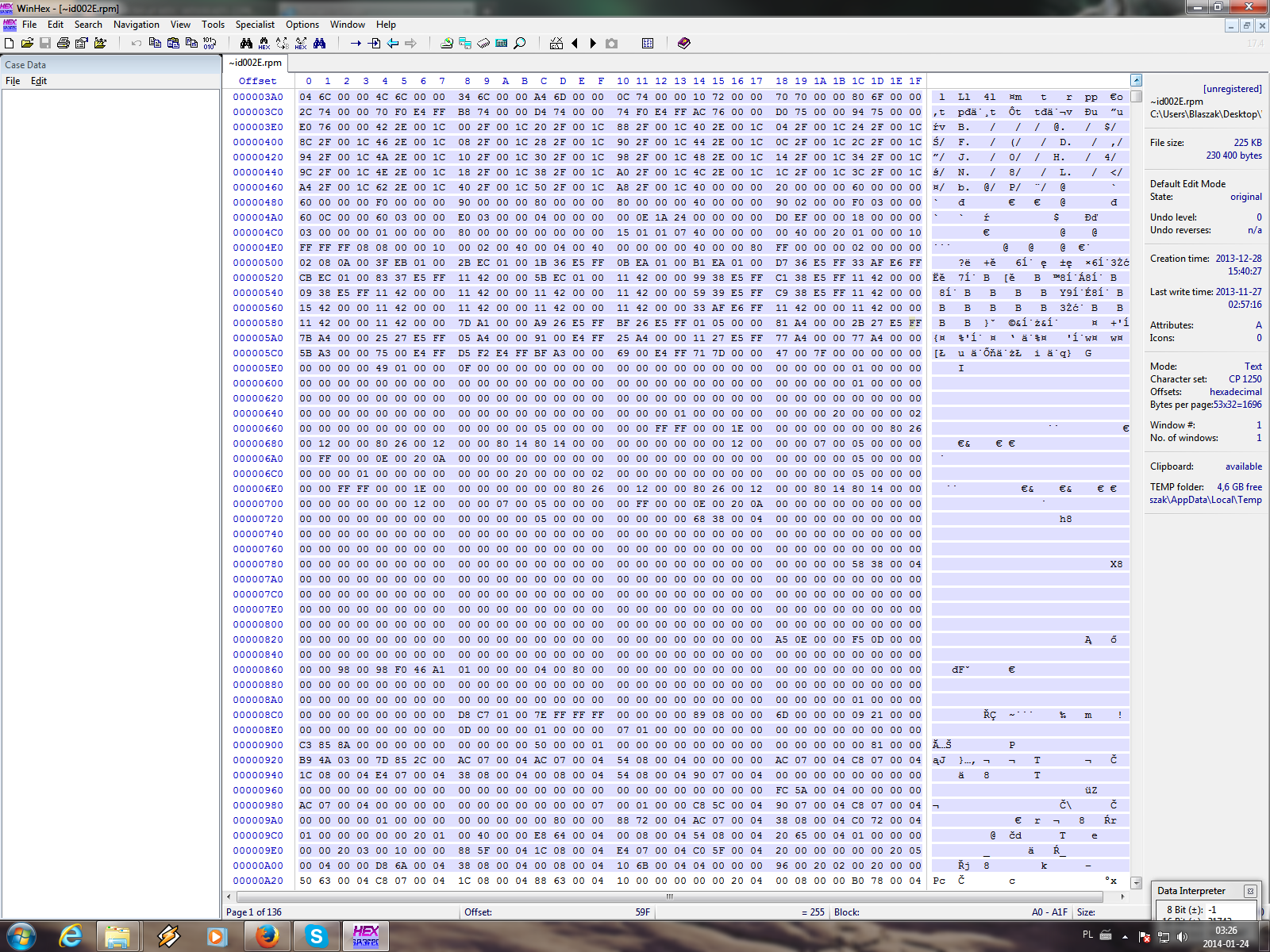

January 23rd, 2014, 22:29
That it will be!?
I think it would be better to verify the fellow himself, because when it comes to a hex editor, it's hard for me with it. btw, 2E module is included as well ....
January 23rd, 2014, 23:22
offs.05978h: 020B
offs.1CC9E: 004F
and etc.
January 24th, 2014, 8:11
Ok, so I look for signatures ROYL? I apologize for my stupid questions, but just some things I can not.
Possibly could to mate same signature analyze which contains mod 2E.
