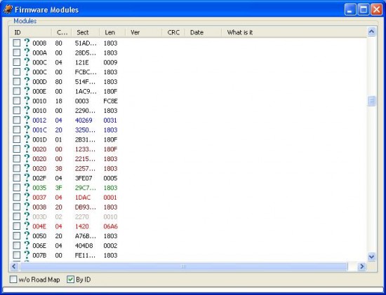

Hello, i've this drive which seem suffering of the relo list crash (very slow sectors reading everywhere), i need to reset the relo list but i can't find MOD 32 on SA with WDR.
I can see correctly SA mods (including mod 32) with Sediv.
Does someone of you know why WDR 3.0 and even version 5.3 don't show mod 32?
I need to reset relolist with WDR because i don't have full version of Sediv!
Thanks.

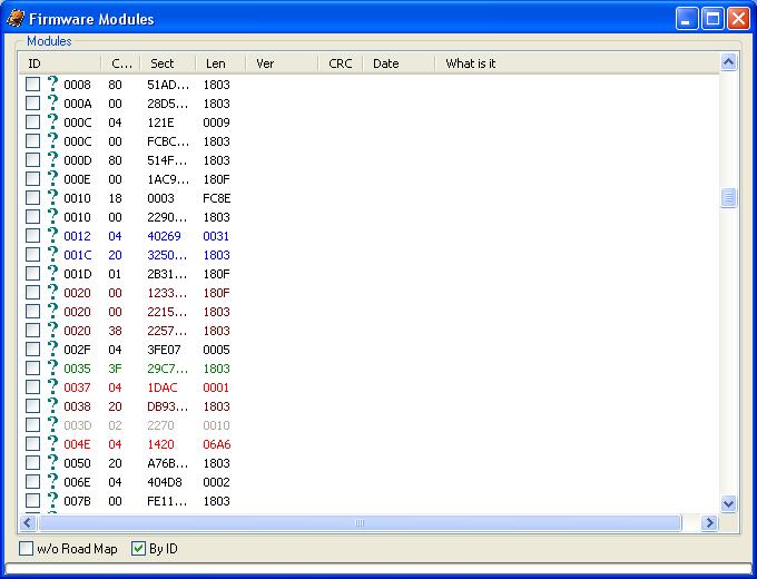

As you can see MOD32 is absent in WDR (i ordered my mod ID)

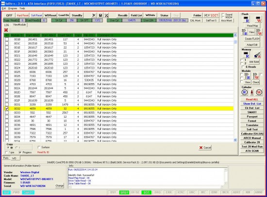

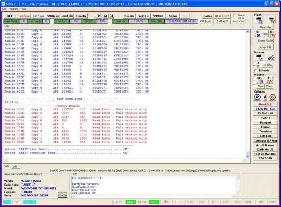

But is present in Sediv:

Don't need to stop relocation, the drive doesn't have any reallocated sector and doesn't even reallocate any sector in DE (because i set reading with very low readiness timings).
Did never happen to you that WDR is not able to show correctly SA mod, but having any problem with pc3k or sediv?

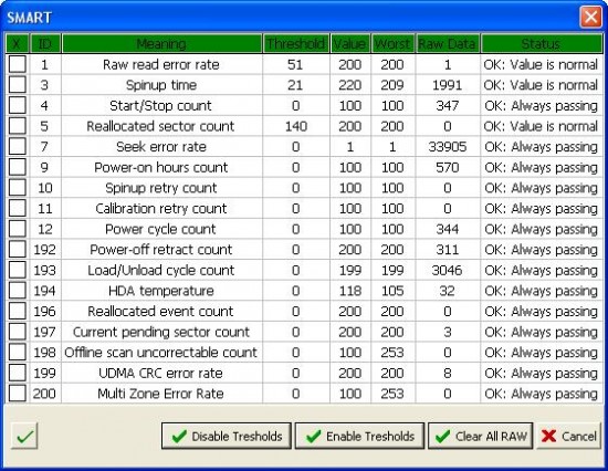

I don't have UDMA but only PCI version of pc3k, also i dont have full Sediv.
I have only WDR and WD Doctor (Salvation), both of them are full version but they don't show me correctly SA mods so i'm afraid to do any mod writing.
Reverse reading in DE in this state it's much more slower!!

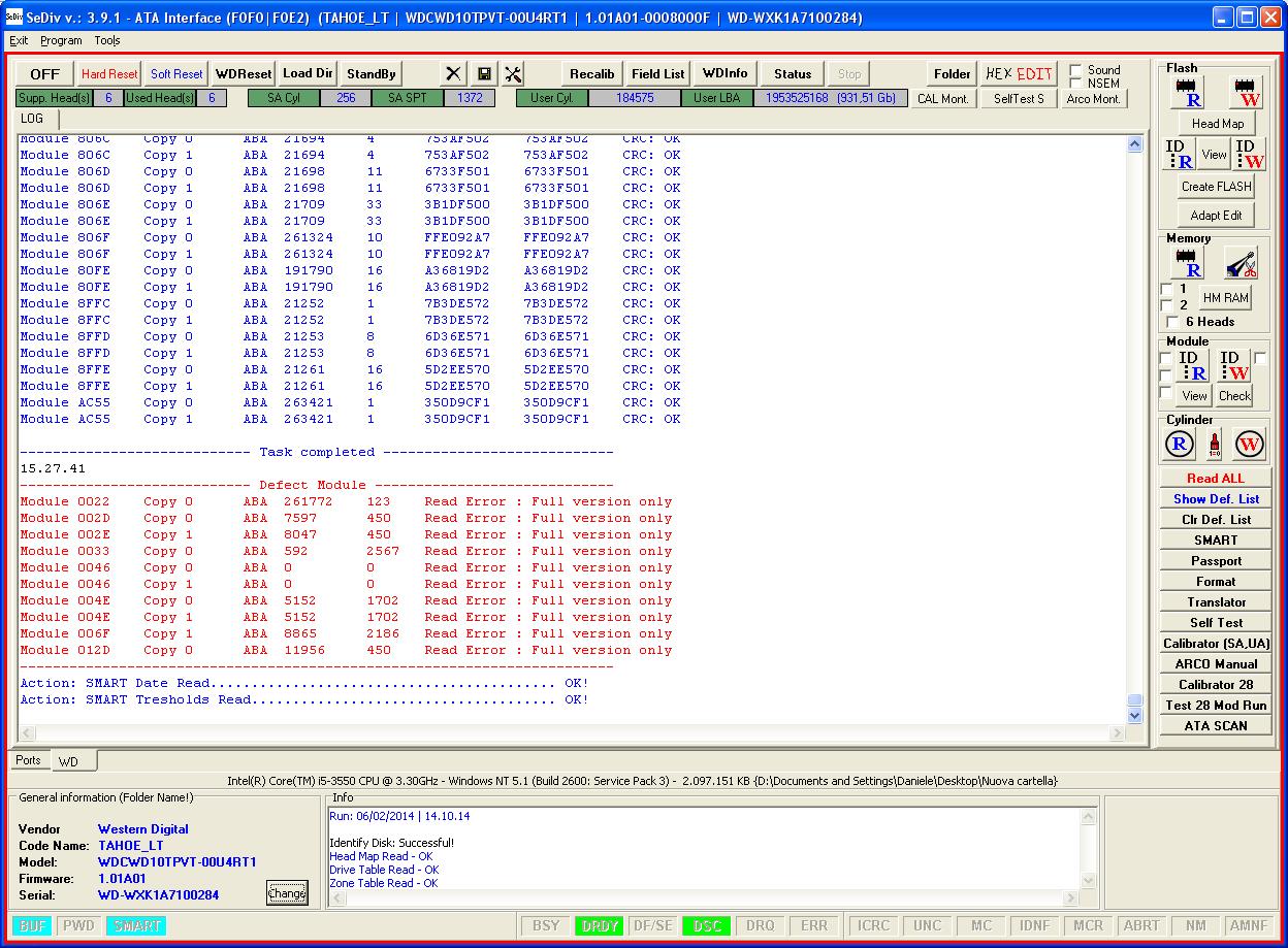

I did ABA reading in Sediv and i got some defected mods:
I don't get any mods error by ID reading.
My firmware database:

Fixed!
I had only to push button "slow repair" in HD Doctor :lol:
Now i'm cloning to full speed! 8)
