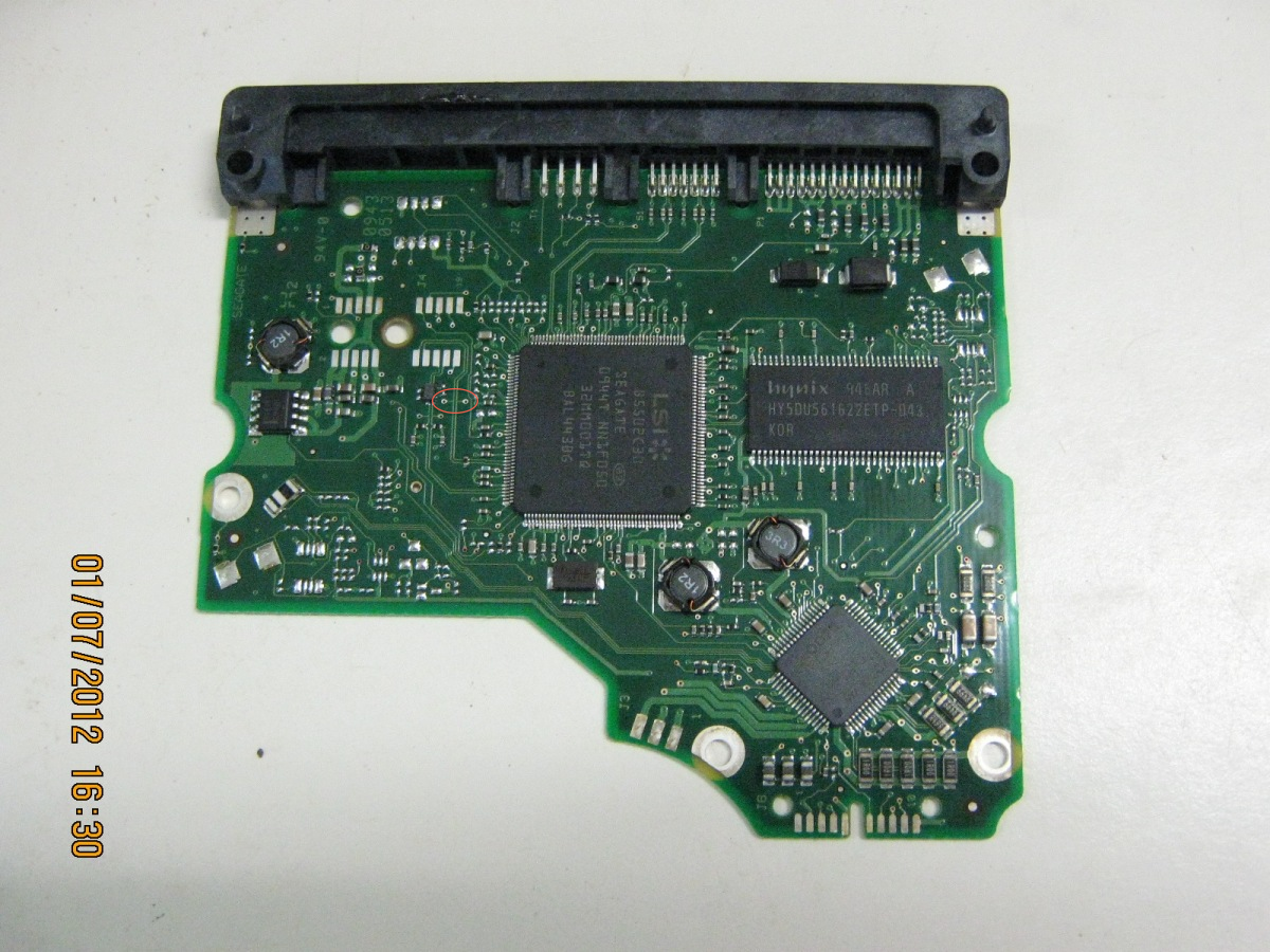

how to recover data from 2tb segate drive . there is no clicking sound and no noise . bios recognized only first time . after terminal command by pressing Ctrl+z = there is no response the model is st320000542as . firmware cc95

Upload a photo of the PCB. There may be an easy, no cost DIY fix.

SEgate pcb

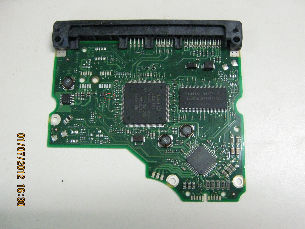

On the pcb picture are marked two points with a red circle, that are for the read channel, sometimes pcb have locked read channel so user can't work in terminal.
To enable the read channel you have to short those points at the right moment (few seconds after power supply has been applied).
P.S.
If you remove the ROM chip, or if it has not been installed properly, the drive will not spin! (you need to do a good soldering job to make it work).
If the installed ROM is not the original one of the drive, then the drive will spin but you would hear head clicking sounds and no BIOS detection!

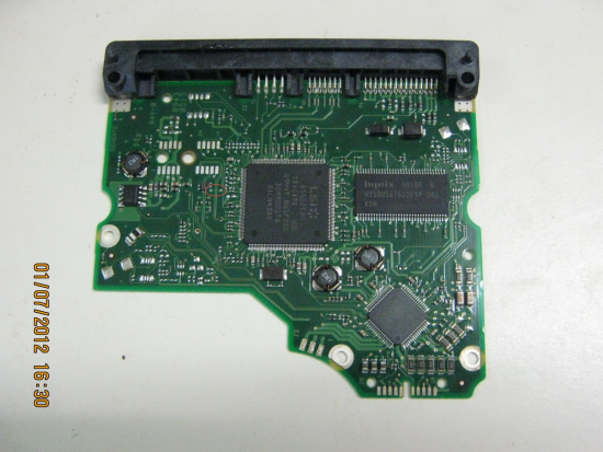

Test points ...
