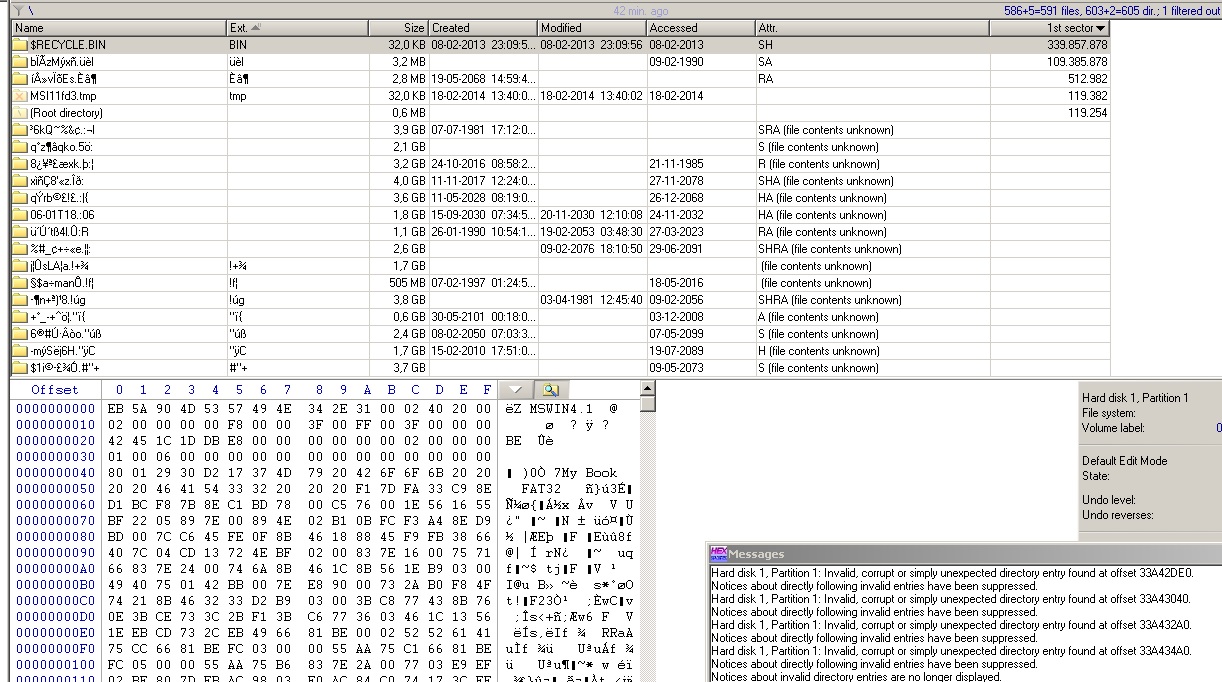

Hi everybody,
I have a WD where all the folders are corrupted. I already got some raw data using softwares like RS, but i want to try to repair the file system. In winhex, the hdd shows like this:
I allready imaged the drive 100%.
Can anyone give me some tips to help with this.
Thank you all.

I've seen cases like this when I had problems with a JMicron bridge in an external USB enclosure. The data transfer would hang, and the file system would become corrupted in much the same way.
If there is any chance of recovering files and folder names, there would need to be corresponding directory entries. I don't use WinHex, but a disc editor such as DMDE enables you to search for FAT directories (Tools -> Search for Special Sector).
Sorry if this sounds like an ignorant question, but the offset of 0x0 suggests that the hex dump is of logical sector 0 of a FAT32 volume rather than physical sector 0 of the physical drive. Am I right?

1 - All the folders disappeared, and only 16 files are visible in the root. But the occupied space in the drive still remains.
2 - I did nothing to fix the problem, i only scanned the drive with softwares like R-Studio and getdataback. I was able to recover files but only in raw. No folders or files names.
3 - I used Atola insight to image the drive. The drive imaged 100% with no errors.
No problem fzabkar, thanks for your time. Yes, this dump is indeed from the logical sector. I will try DMDE.

Special thanks to you, fzabkar. I was able to recover everything with DMDE.
