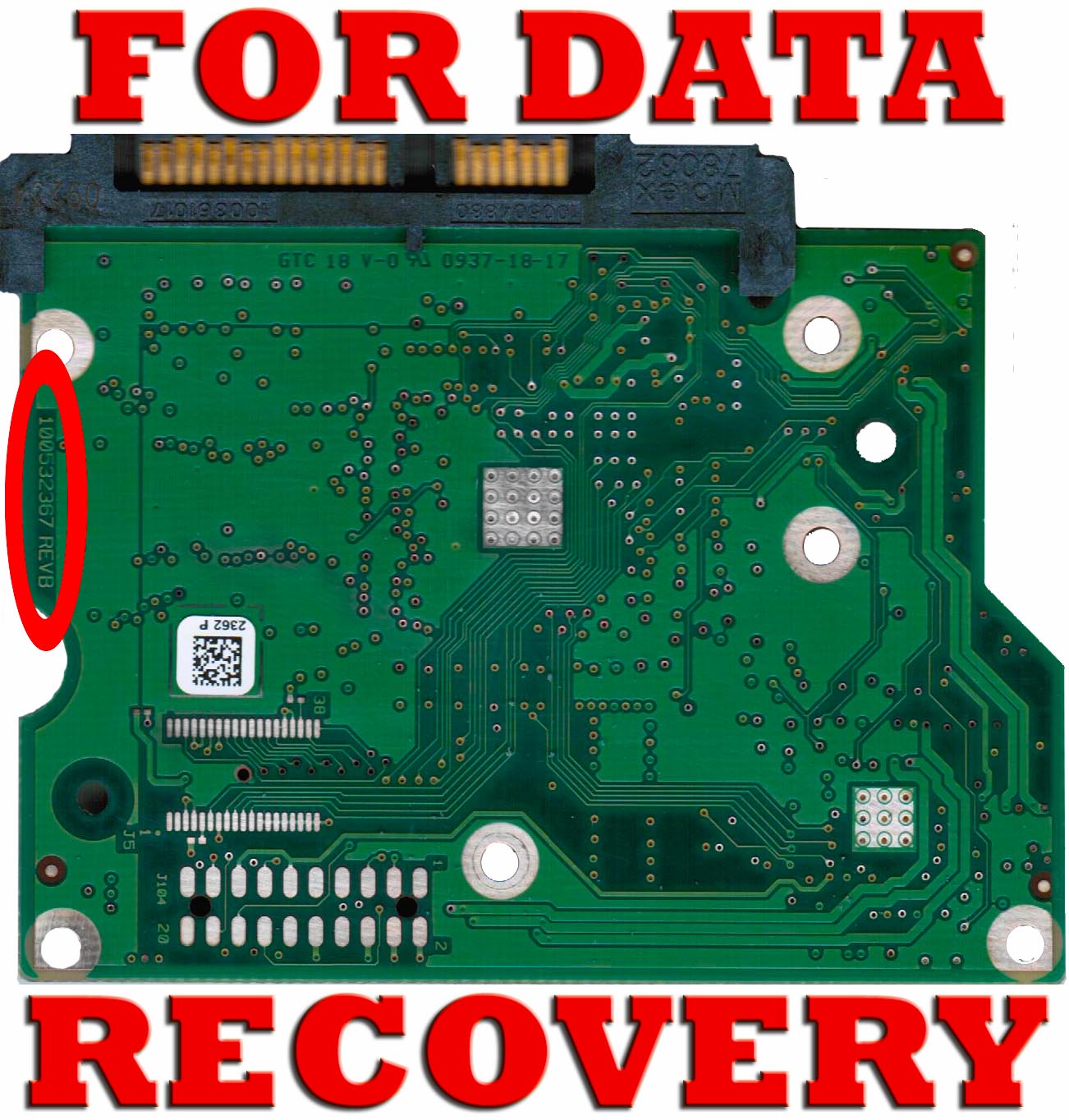

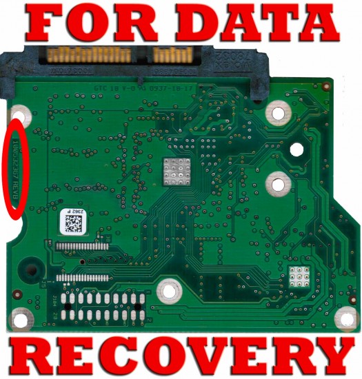

I have the ST3250318AS FW:CC38
with the brick problem.
I looked at the pictures in the other fix post but they don't look like mine
http://qbhn.neostrada.pl/02.jpg
Here is mine, is there a fix for this one?
http://ep.yimg.com/ca/I/yhst-4446369223 ... 4_14347775

Picture of PCB that mine looks like since the other doesn't work.

I did and update and was asked to reboot, when I did it came up with a black screen "NTLDR" I did another reboot and then it failed to recognize the drive. Can't see it it in the BIOs but the drive makes no noise, but does spin, very smooth and quiet.
Just hoping for some guide lines. My PCB board as stated, doesn't look like the ones pictured.
Thanks for any help :)

Are there pins to jump for read chanels like in the other drives?
I only saw that in the 500 750 & 1000 7200.12 directions.
Notice.... the 250 PCB board looks different from the others.

I have another drive with exactly the same #'s, so I switched the PCB boards but that didn't work.
I was able to do that once on a Maxtor drive and it did work, but not this time.

Switching boards will never work on 7200.11 models and later. That's because each board stores unique, drive specific information in fllash memory.
I would do as advised and obtain a report via the serial terminal port. This will tell us what is wrong with the drive. Don't send any commands that write to the drive.
