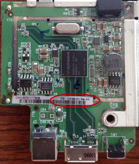

Maybe I have the terminology wrong. Maybe it's the "bridge board" that I'm replacing, either way below is an image of what's being replaced and what I've seen discussed in threads on this msg board as a common cause for these drives not being recognized. Does anyone know if the Rev on this board makes a difference as long as the number is the same? Would appreciate it if anyone knows for sure...

The rev shouldn't matter for this purpose.
However, we rarely see these boards go bad unless they are physically abused. It' most likely a firmware or hardware issue with the drive itself.

Just had a powered USB3 HUB fry and take ALL four attached MYbook PCB controller cards out. I have one good PCB that was not connected. Plugging it into the four "dead" Mybooks brings them back 100%. Obviously no problem with the HDD's or the HDD Controllers. The dead External PCB light doesn't come on unless you hit the on-off switch and then it's solid on, without blinking as per normal. They are never recognized by XP, 7, 8, LINUX, GPart or anything else.
Could be U4 8pin as has been suggested but my days of trouble shooting circuit boards with jeweler's glasses & tweezers are behind me. ALSO worth noting that even though the drives aren't recognized with the dead PCB controllers they spin up and sound completely fine. They can be seen via direct SATA hookup but you HAVE to have those %$# compatible external PCB's to decrypt.

@streetskater, ISTM that that the firmware chip (U4) might indeed need to be transplanted. However, rather than desoldering it, it might be easier and safer if you could read and write it in-circuit. You could use an SOIC IC clip and EEPROM programmer. I would practice on the donor PCB before working on the patients.
BTW, if you connect the working PCB to a USB port and power it up without the HDD attached, does it appear in Device Manager? Can UVCView or USBDeview see it?
