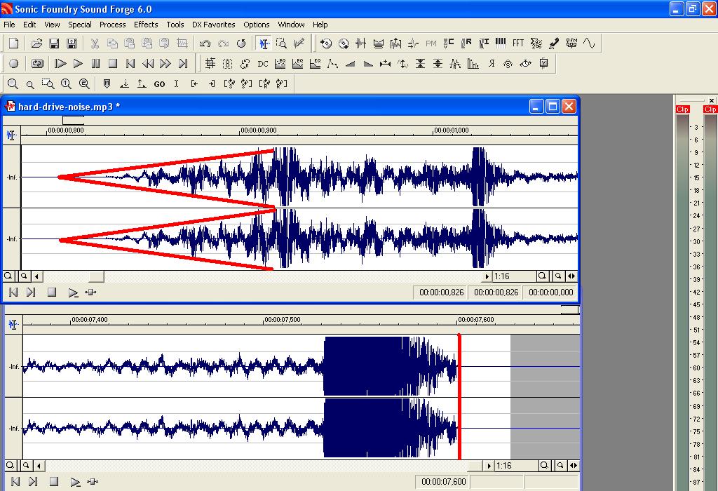

Matiw wrote:
Here is my novice observation.
I can not hear the HDD spin-up and spin down. The noise starts right away after power up and stops suddenly (no sound of spin-down). I go for stiction. In addition there are two sounds involved; one seems to be a typical sound of stiction, the other seems to be a sound of the platter trying to spin and there by drag the stuck-head around the pivot point (the stiction point).
Recorded sound is incomplete!
At the beginning of the sound fade in is noticeable and the end is simply cuted off, so these are the reasons why is not possible to hear spin up and spin down - they are not in sound file!
