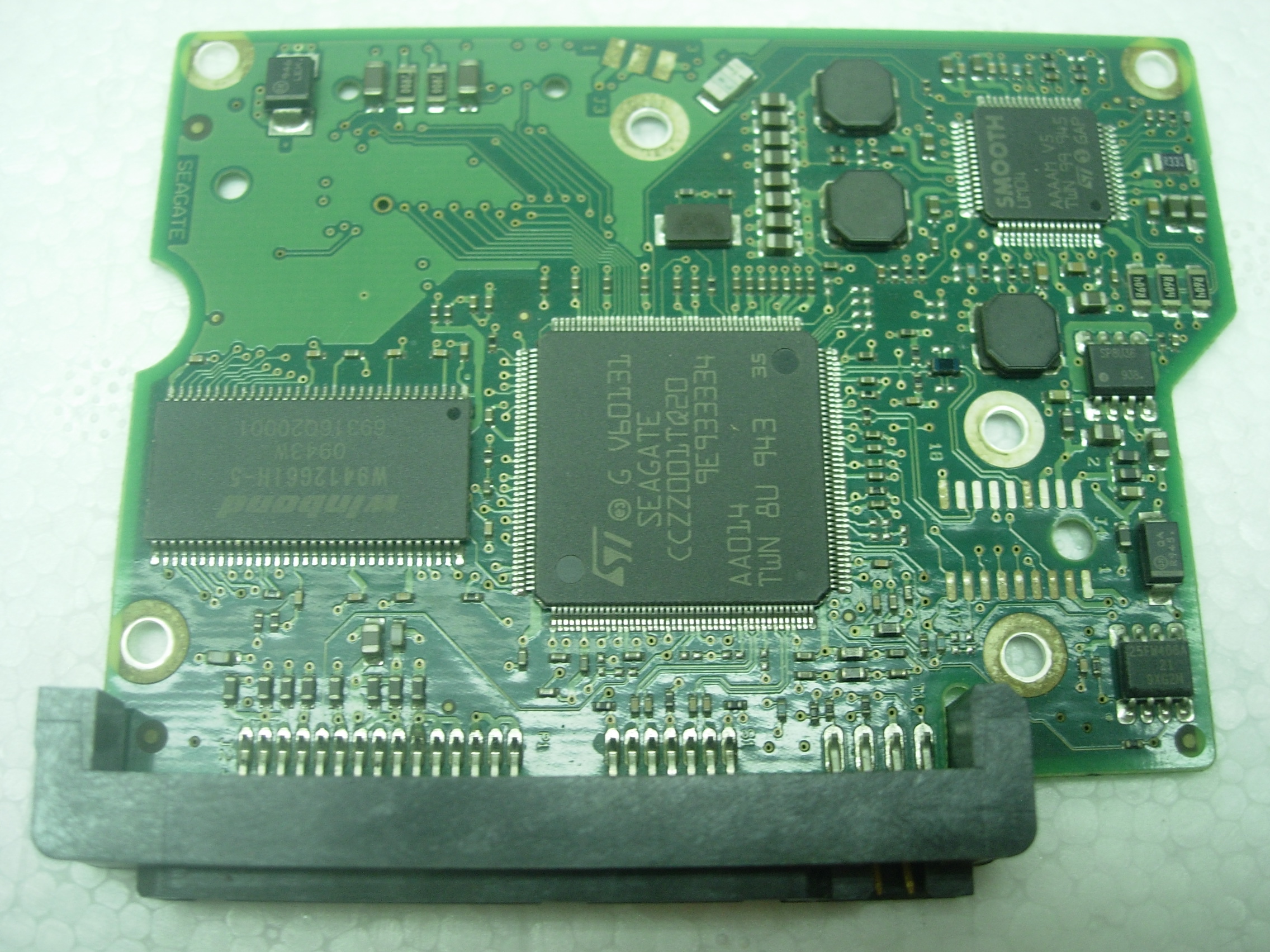

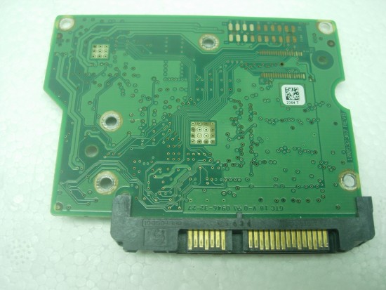

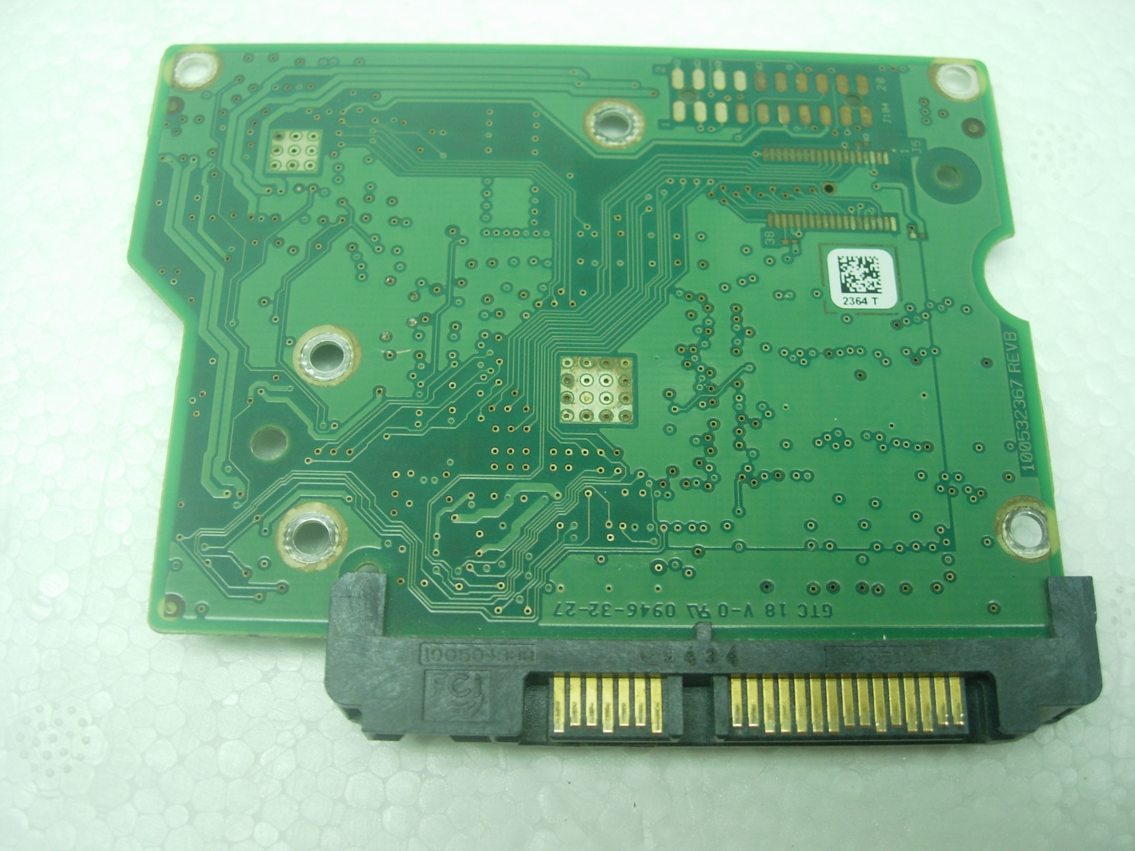

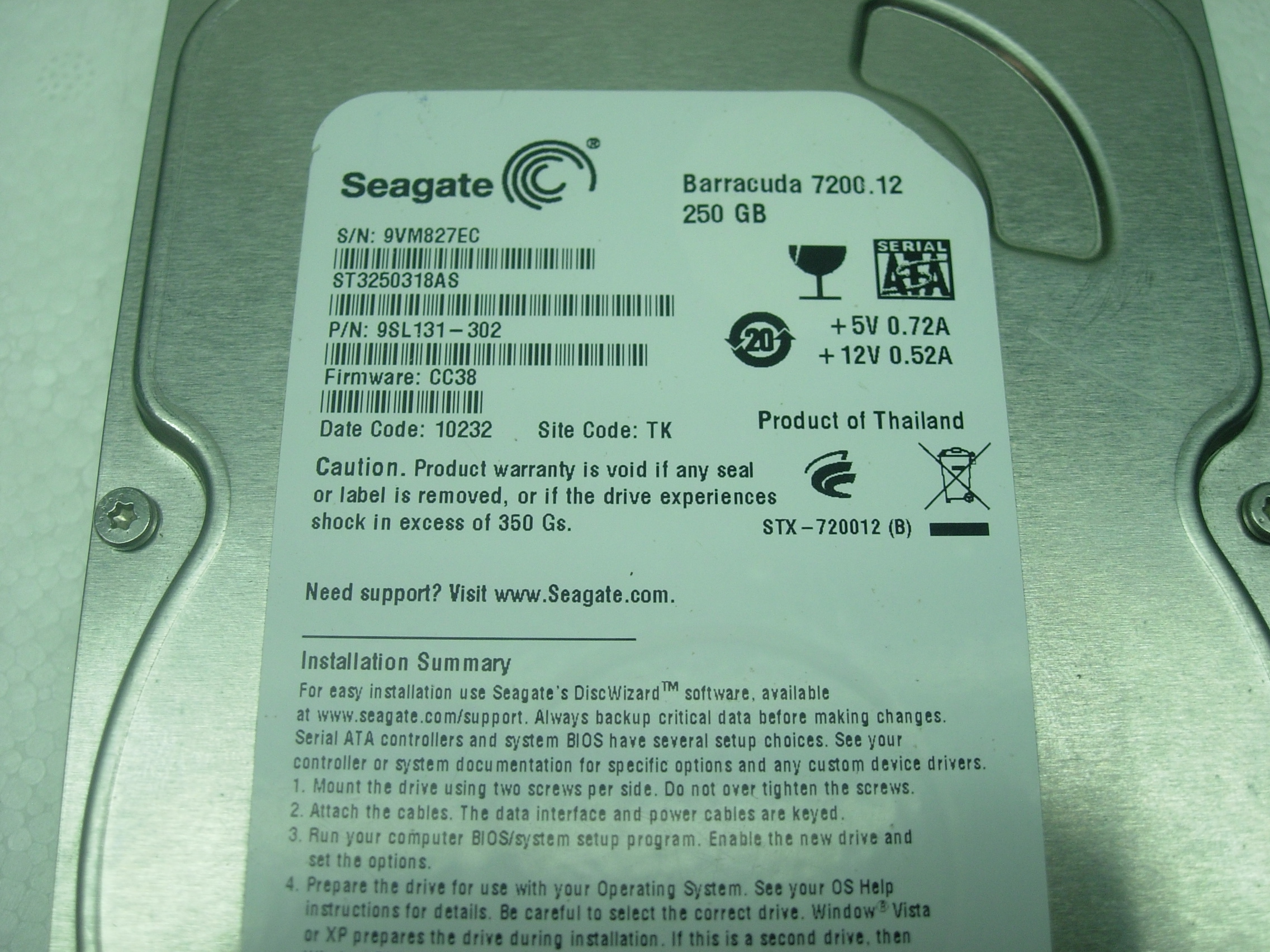

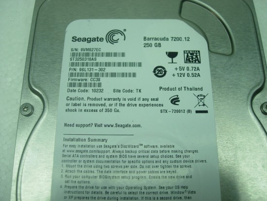

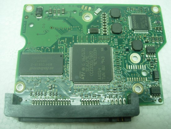

Seagate, Barracuda 7200.12, ST3250318AS, FW: CC38, PCB: 100532367 Rev B, 250GB
F3 T>^C
Spinning Down
Spin Down Complete
Elapsed Time 6.012 secs
Delaying 5000 msec
Jumping to Power On Resetý
Rst 0x08M
No HOST FIS-ReadyStatusFlags 2002A185
ASCII Diag mode
F3 T>
The terminal answer any commands, but HDD is not recognized by the BIOS or
the Operating System.
These images show the data on the HDD.
Wath can i do to solve this throught the terminal?.
