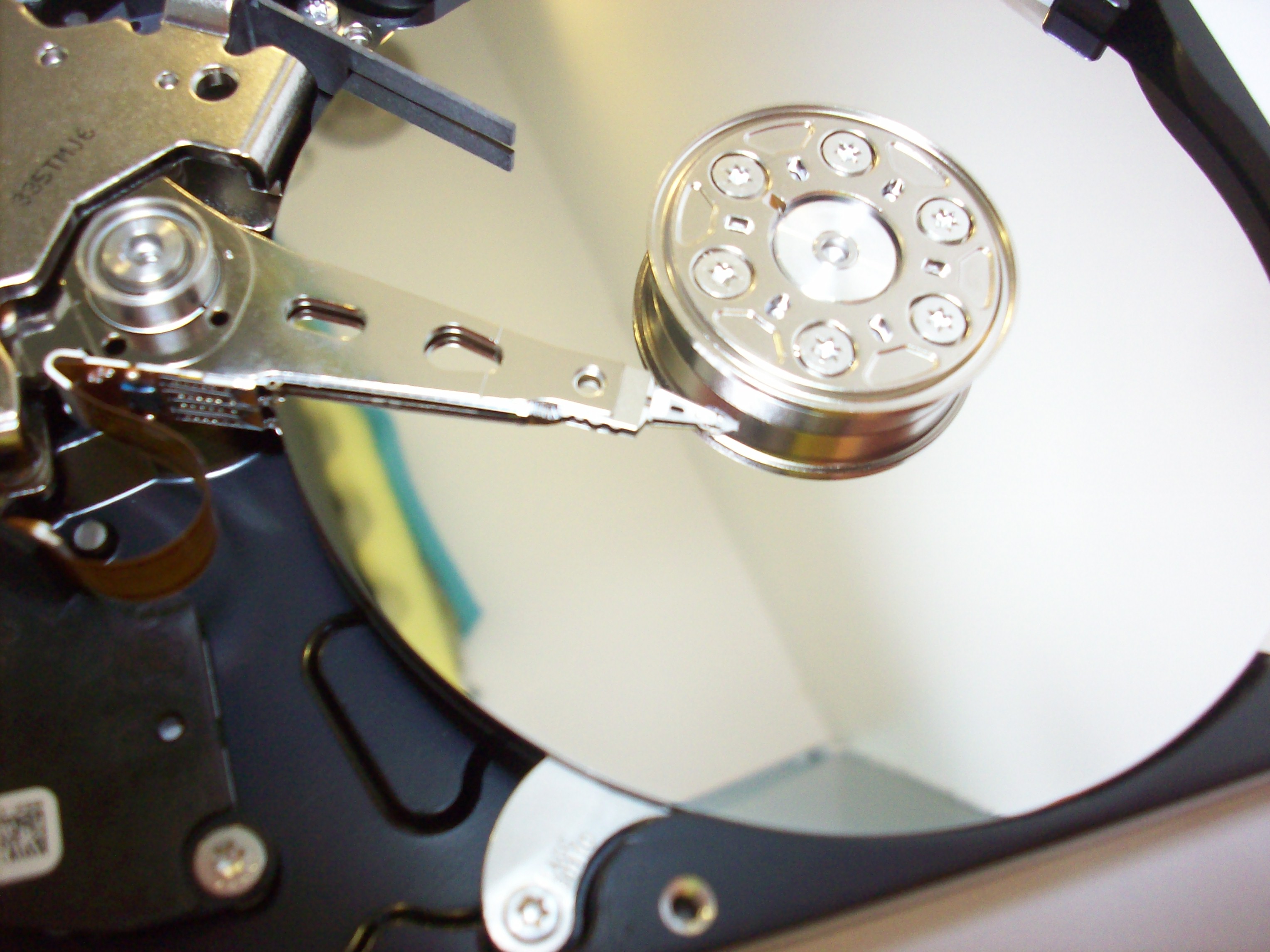

An ST3500320AS (SD35) is clicking for some time, then stops spinning after having parked the heads arm in the middle of the plater, leading to a nice sticktion, every time.
I haven't seen such a case before. First thought was corrupt ROM. Does anyone more experienced have any idea what could be the cause of such behavior?

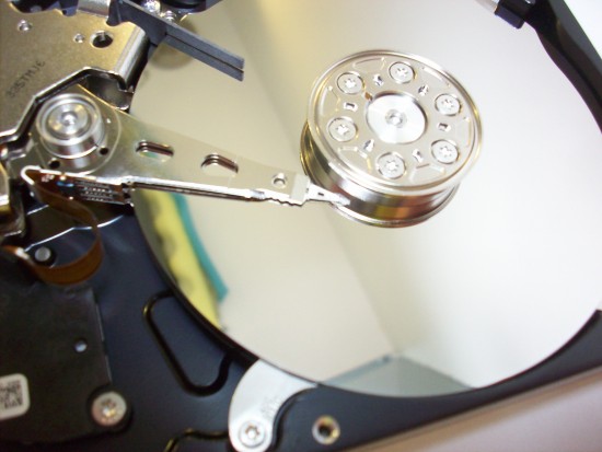

I'm afraid this is the best I can do for now.
The drive was an internal one, and it has been opened before elsewhere. This is all that I know for the drive's history.
The headstack clicks swapping the whole platter radius, and pausing momentarily for 2-3 times at positions about the middle, until "parking" at the middle before spin-down.

I think this HDD will not be recoverable, if HDD was opened in other sites, is very difficult to work, you do not know opening conditions, and what testing, pieces exchange, ... they do it, hard to work in this condition.
But i think you have heads problems or maybe media damage.
As BlackST says, a pic from heads under microscope will be good.
