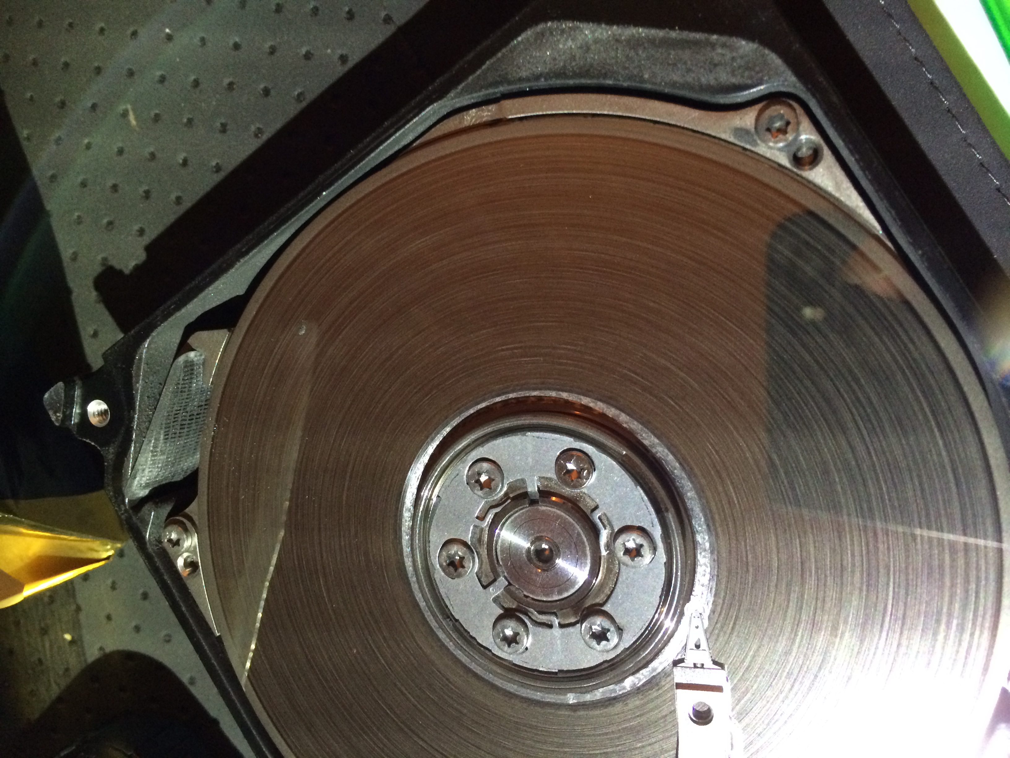

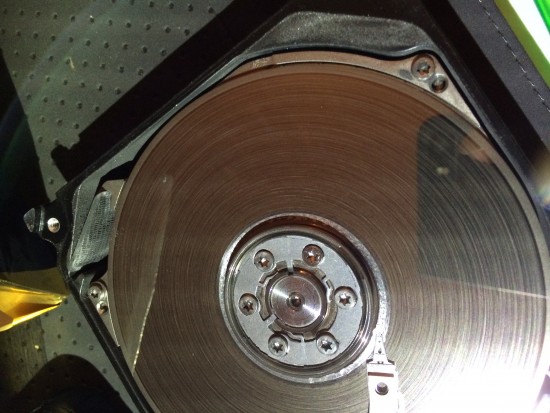

Dear all,
I just tried to find out what's wrong with my seagate drive.
Could anybody say what I have done wrong.
At first I got this noise.
09.06.2014 21-02-27_1.zip [483.55 KiB]
Downloaded 240 times
It sounded quite terrible.
So I opened the drive and have seen a lot of smudge on the platters.
Would it be possible to still get the data there?

No, sorry.
 Post subject: Re: Problem with Seagate 7200.10 ST3750640AS
PostPosted: July 15th, 2014, 2:36
No chance :-(
PostPosted: July 15th, 2014, 3:32
Posts: 811
Location: World
Not posible, You got very severe media damage.
your data now is dust!
sorry, no way

Hm, that doesn't sound fantastic. But what would do a professional company? Would they be able to do something here.
I think the platters could be cleaned, couldn't it?
PostPosted: July 15th, 2014, 14:05
Posts: 17323
Your data is in the dust in the filter.
PostPosted: July 15th, 2014, 14:18
Posts: 456
This isn't a motionless body, this isn't a corpse, this is a bare skeleton, unfortunately.
P.S.
Reminds me of a drive we saw sometime ago with its heads stuck, when the client decided "to think more and probably try other options first" and went to an electronics market, where "master" left their drive for 2 or 3 days with HDD Regenerator running.
Situation was quite similar when they visited us for the second time.
