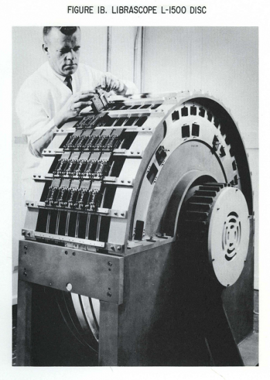

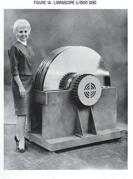

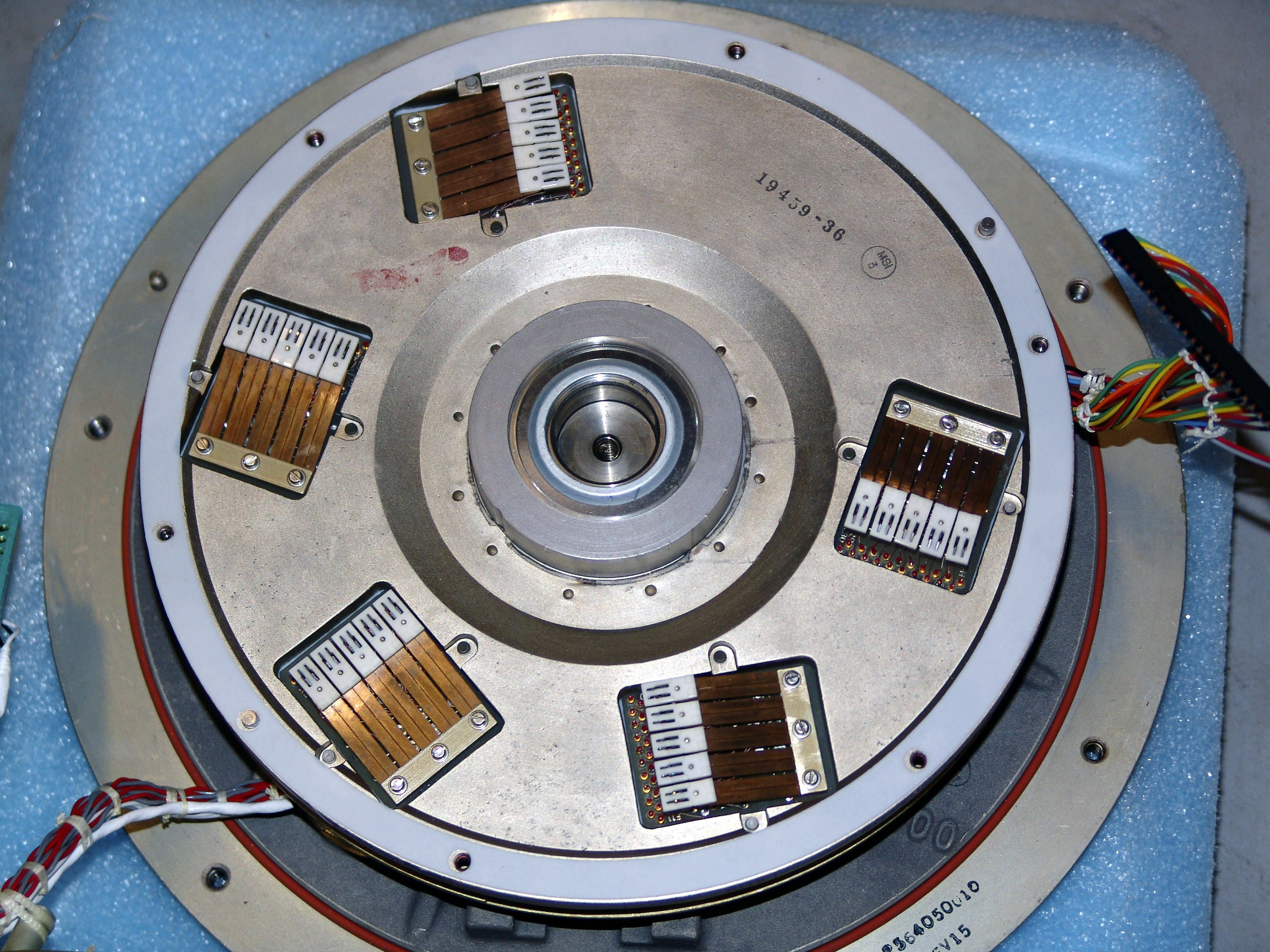

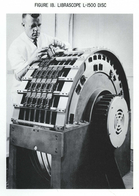

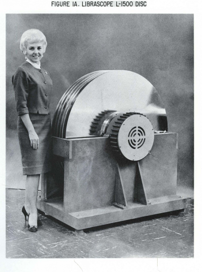

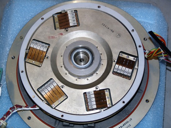

Singer/Librascope magnetic memories had 1 head per track.
http://www.dvq.com/oldcomp/misc.htm

An inventory control system on 1/2 a megabit... wow
startup time 5 minutes, thermal stabilization 2 hours. holy Toledo.

It would be costly to manufacture a thin strip head running the radius of the disk. The yield would be low and then how would you deal with spindle wobble and fine tracking? Furthermore you'd have to make this strip-of-heads have gaps. And the tracks would need to be wider to deal with temperature expansions - which is non-linear across the surface.

Multiple stationary arms covering the whole area:
Way too many tracks and temperature expansion issues. This idea did work in the 60's and 70's as shown in the pictures above. But note the warm-up and stabilization times. And the low data density.
